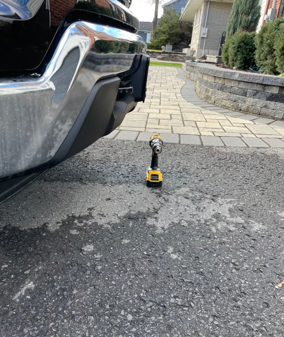

Here are some pics, video won’t load
it can zoom down to see something this close, or pan up with a swipe of your finger
the drill is very low!
pretty easy to install. Parts fit under the Onstar plastic housing at rear view mirror
