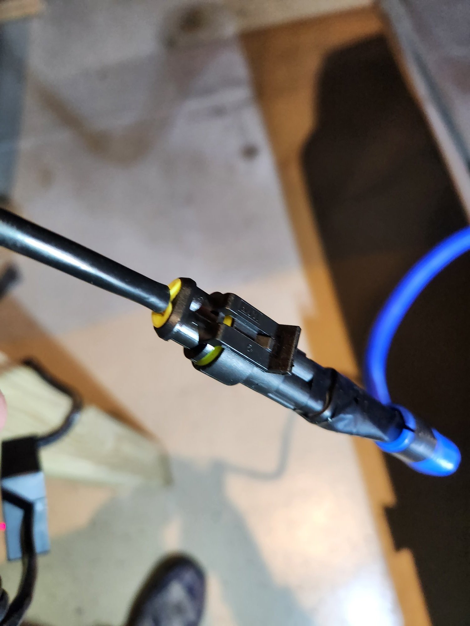

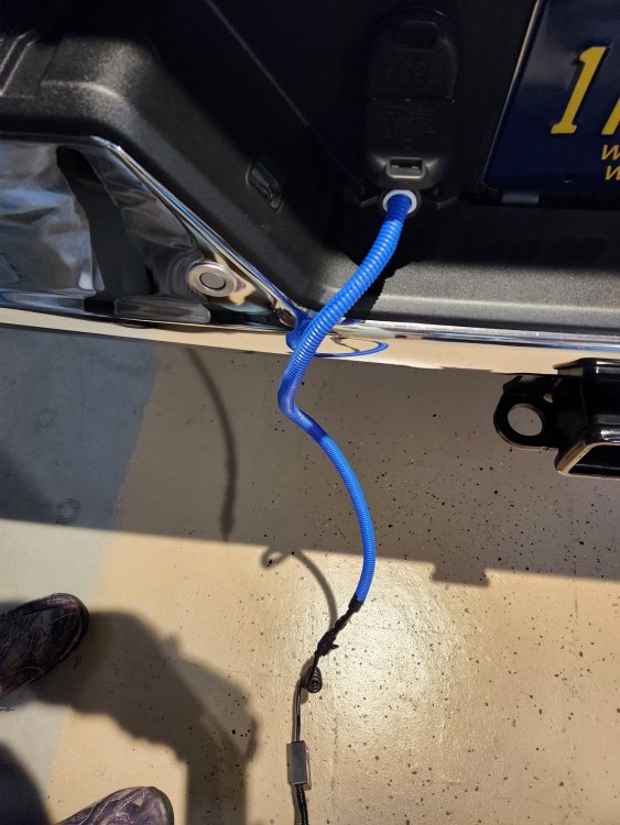

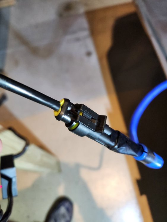

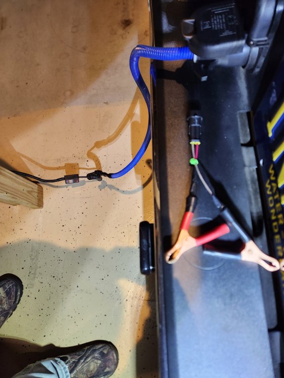

I got my trailer side 7 way plug today and connected the wires and the plug to it. I am using a cheap Harbor freight trickle charger because I am only going to connect it occasionally. If I was leaving the truck unattended for a while I would use my other charger, only because I trust it more than the cheapie from HF. I used the weatherpack fittings because that what I already had on hand but any 2 prong connector would work since its going to be indoors. I now have the set of alligator clips and the 7 way plug that I can switch back and forth. Other than the $6 on Amazon for the Curt 7 way plug I had everything else on hand. Much easier than having to set the charger under the hood, now it sits on the workbench behind the truck and all I have is the cord.

So this maintains your battery from here?
are you using the ultra cheap hf one or the one that’s a little bigger with the green and red lights? The 20.00 one I’ve had great luck with but the ultra cheap black little box one I had bring a power sports battery up to like 16v. Tossed that one.
Yes, I tested the battery after hooking it up and it was charging fine.
I am using the really cheap one from HF, so far it has worked very well. Usually around 13.4 when on and the battery ends up around 12.8 with it off so the numbers are good. I really do need to get a small NOCO for this but as long as the HF one keeps working I cant bring myself to spend the money. I only put it on for a day or so every couple of weeks. During the winter the truck mostly sits unless we are traveling.
