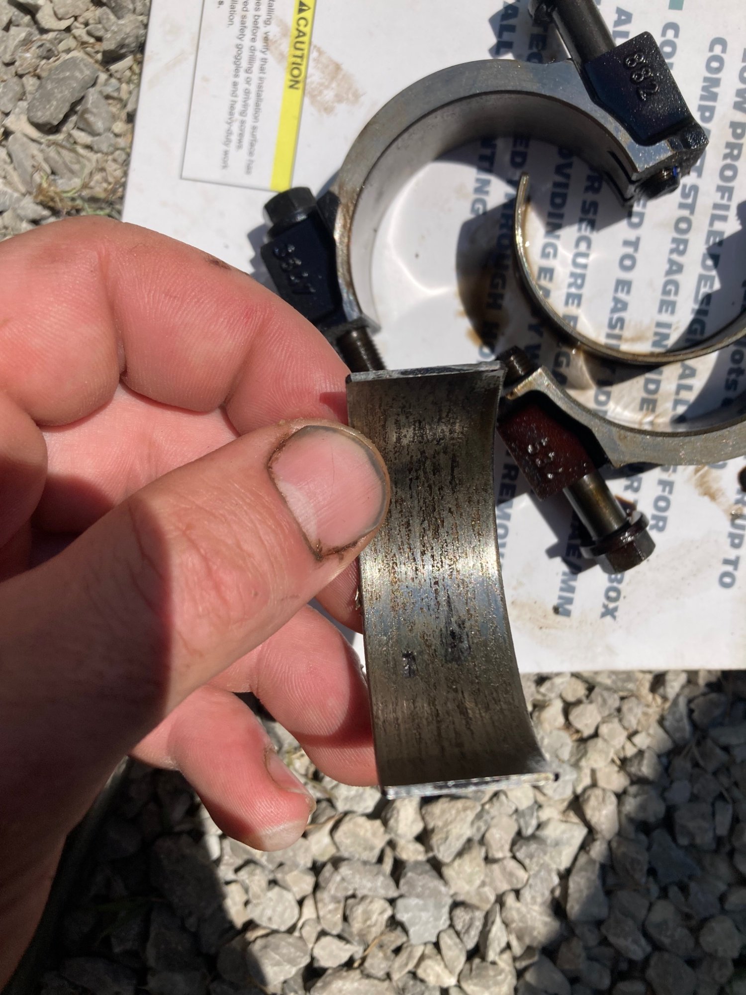

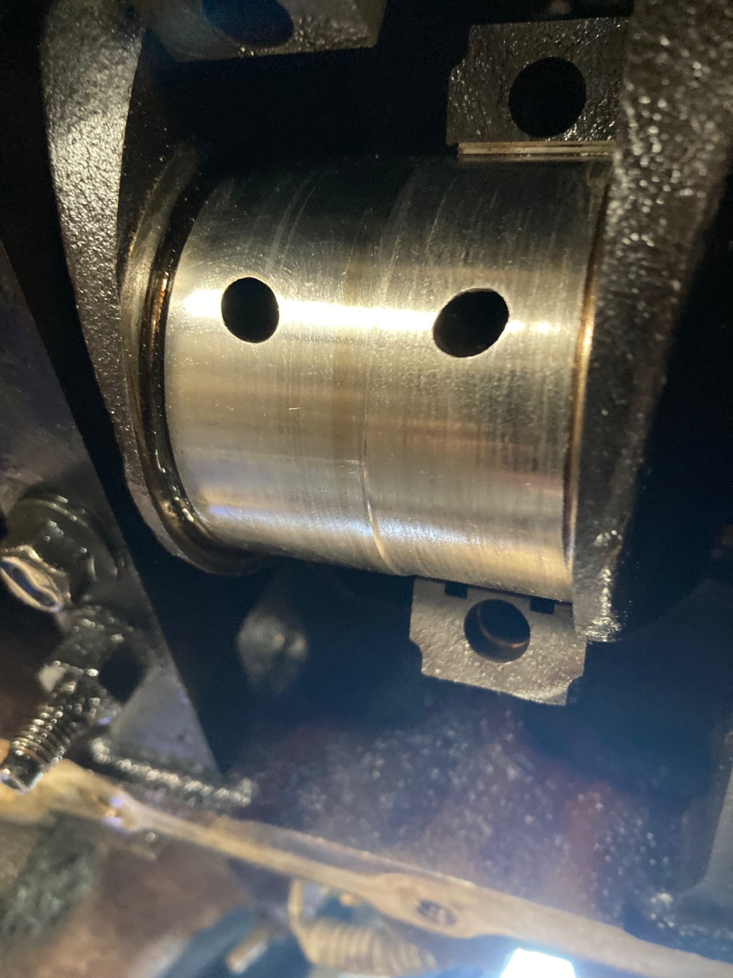

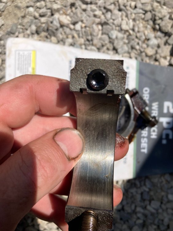

You nailed it on the rod. The bearing was gone on the cylinder I could here the knock the best on.
I have a new question, the crank and rods do not have visible signs of wear fitting metal on metal contact. What I mean by that is the are smooth with no tracking. However, I am noticing where the bearing was shot that the crank has a noticeable step on the compression side and if I didn’t know any better I would assume it was turned that was.
Is it possible to just replace the bearings or do I need a new crankshaft?

I did use one, the knock only resonated through one cylinder, but all lifters, injectors, and valves were functioning and consistent. I didn’t check the oil pan with it, but did pull it today and it is a rod bearing failure.
I haven't done a motor in years but a machine shop can tell you whether that can be fixed and run larger bearings to compensate.  Used cranks are plentiful I'm told.
