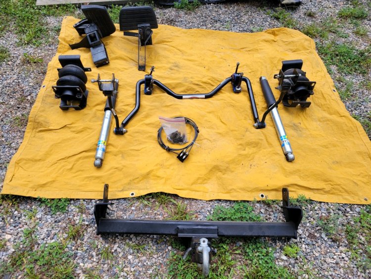

Body Roll.......The GM 1500 & HD trucks do NOT offer a Rear Say Bar as an option ( Only 3500HD DRW Chassis Cabs I have seen come with them).  I had a '16 2500HD Duramax Denali. was NOT pleased with handling , with a Fiberglass cap, Bed Slide out and my tools.  I found 1-1/2" dia.  Roadmaster Rear Sway bar kits on e-Trailer.com, as well as Firestone 3500 lb. rear air bags, and Bilstien series 5600 shocks.
Installed these and Holy XXXX Batman, drove like it was on rails.  3200 miles later, was in  middle of a multi vehicle pileup .......
Insurance totaled it wit 62k mi. on her. I saved these suspension upgrades to put on Craig's List and e-bay. Will fit a '11 to '18 2500 or 3500 HD.
Awaiting my 2024 2500HD Denali Duramax. Built on May 25 in Flint. Still shows,"In Transit".   FYI : I already have a new Roadmaster Rear Swaybar to put on the '24 when she arrives.
Sounds like the Rancho's on it will be going into my metal re-cycle 55 gal. drum soon. I loved the Bilstien's, but will look into the Eiback, Fox and Ride-Tech by Fox. ( Put Ride-Tech's ['11-'18 GM 3-4 TO 1 TON SUSPENSION UPGRADE.pdf'11-'18 GM 3-4 TO 1 TON SUSPENSION UPGRADE.pdf same as Hotchkiss but much less $$ ]  on my '78 Trans-Am, and are awsome   !! Has 24 way external adjustment valving. ).
