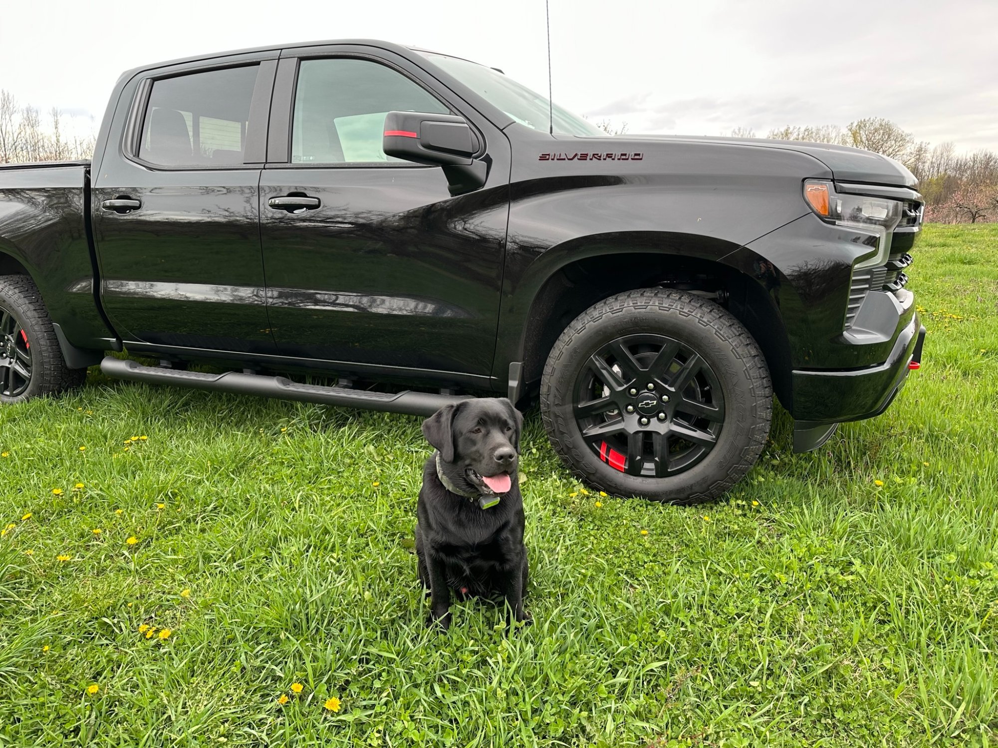

Oh and pic of the truck, which I otherwise love haha
