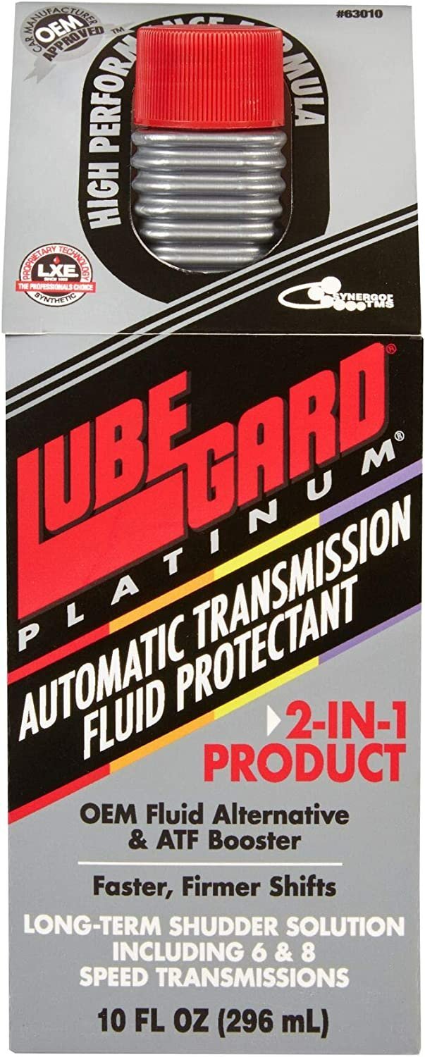

Sure sounds like the Converter.  If you don't know much about transmissions I would get a second opinion on the fluid.  If it was recently serviced then you could try dumping in some Additive.  Might buy you some time.
