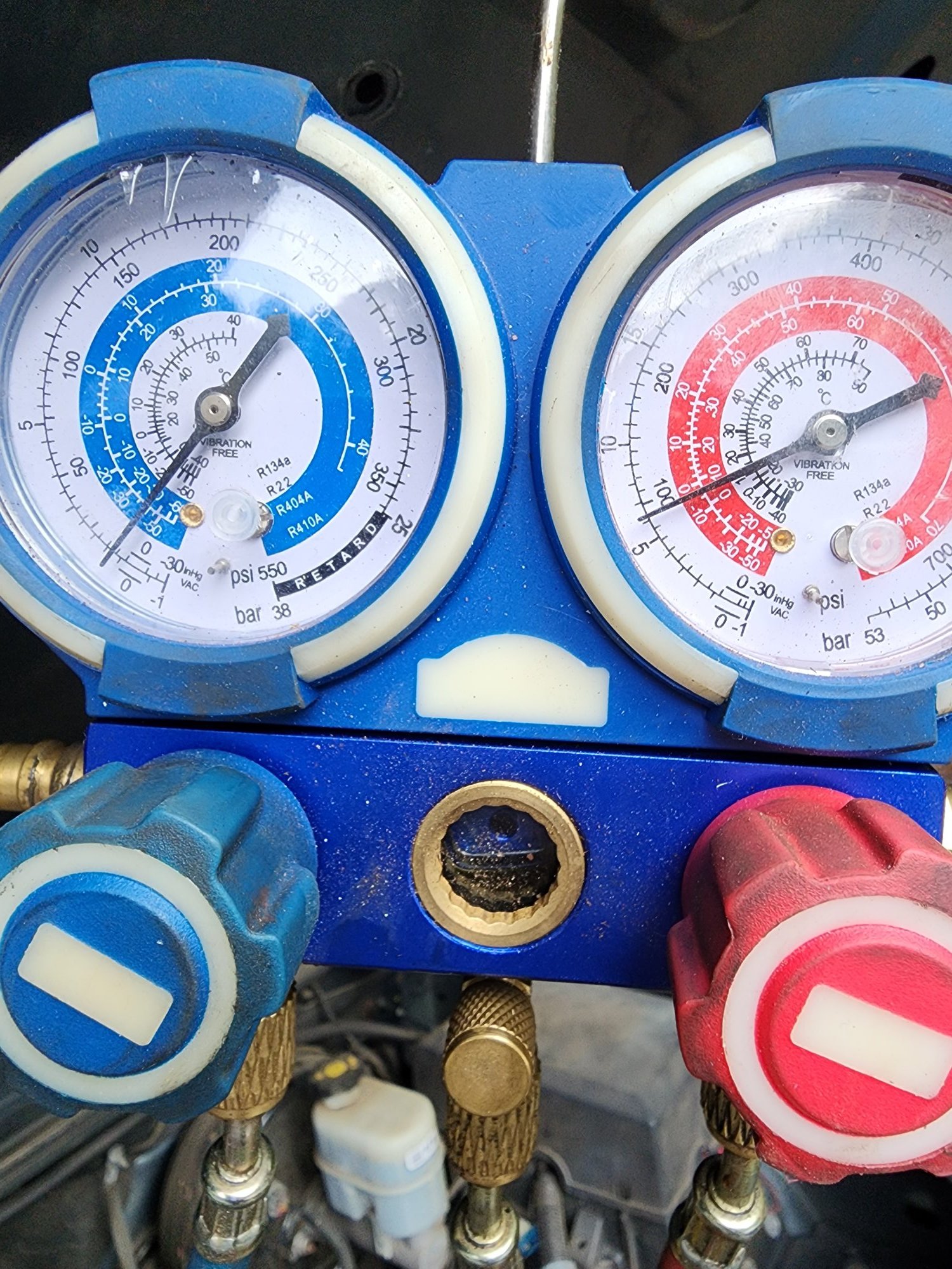

High and low side both reading as pictured. Compressor will not engage, switched relay and checked fuse but still nothing. Yesterday I was able to engage the system with a scan tool but its not working today for some reason.
Ok so I finally got the A/C system to turn on. Reason it wouldn't turn on was operator error on my part. Anyways I hooked up the pressure guages and they read as follows in the pictures. The system ran extremely cold for 40 minutes or so before the accumulator started to freeze over and moisture fog started coming out of the vents. Once the moisture fog started coming out I started losing all air flow from the vents. I let the system continue to run an additional 15 minutes or so while sitting in the driveway and the accumulator eventually thawed out and while it was blowing cold air it wasn't full blast maybe 50% or so. It never regained full blower speed but the air was cold but you can hear that it's either still frozen inside the accumulator or there is another issue. At this point I can turn the system off for 5 minutes or so and restart it and it's back to blowing ice cold air at full speed. The included pictures show the guage pressure when the accumulator was froze over and as the accumulator unthawed itself the low side pressure began to rise. There was no drastic change in pressure at all during the time I monitored the system. What I mean by that is the low side never spiked high or low when the compressor was running and the high side stayed pretty consistent as well. Now with me forcing the A/C system to run would the compressor cycle on and off as normal or would it just run at 1 constant speed? That is the only thing I forgot to pay attention too. So the pictures are accumulator frozen and low side guage reading hardly anything and the high side maybe 125. As the system unthawed itself both low and high side pressures started to rise but very slowly. Also the pressure switch was still reading 1.16 V. The picture of the accumulator frozen would not upload due to size but the guages did upload.

Actually those pressures, and the fact that it's freezing over would be an indication that it's low on Freon, or the line filter is clogged. But mostly very low on gas.
