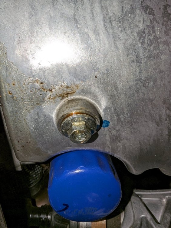

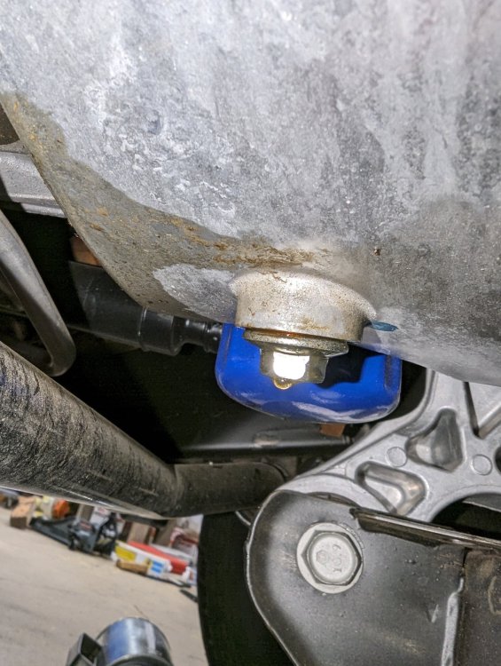

PXL_20231024_023015744.thumb.jpg.1e88334771f229e9c071a79f31763cf1.jpgNew truck leaking oil or possibly trans fluid from engine to bell housing union and above oil filter ... Can't tell what is above oil filter ... Couple lines coming into a block ... Maybe some type of bypass.  Anyone have any thoughts. See pics

Pic add

Went to dealer this morning.  They took one look and said transmission on both pictures.
I agree with the fluid drip on drain plug that is coming from inspection cover of bell housing.  I am thinking front input shaft seal or torque conv seal.
Don't know what the lines are above oil filter.
Have appointment on Thursday.  Will update when have more info.
Traced lines above oil filter back to transmission cooler.  Looks like dealer was right about both leaks.
For the lines from the oil cooler I am guessing an o-ring or o-ring type of gasket is behind there and improperly positioned.
Will get parts diagram while I am at dealer tomorrow.
Still thinking front input shaft seal or torque converter seal on the internal leak.  Requires trans drop to fix.

That leak looks like engine oil to me, the oil lines going to the cooler are a common leak point on these trucks with a few having severe blow outs, i would not waste time bringing this in to have the dealer look it over. Most should have these lines in stock with how common they leak.
Edited by BIGDOGx
Engine oil cooler lines.  You are leaking engine oil.  Its not ATF.  None of the drips are pink or reddish pink, its engine oil.
Same for the leak at the plug and the leak behind the plug, it all looks like engine oil.  Rear main seal to the engine would leak engine oil in the bellhousing/back of the oil pan area.

Here's some updated pictures of their "fixes"
