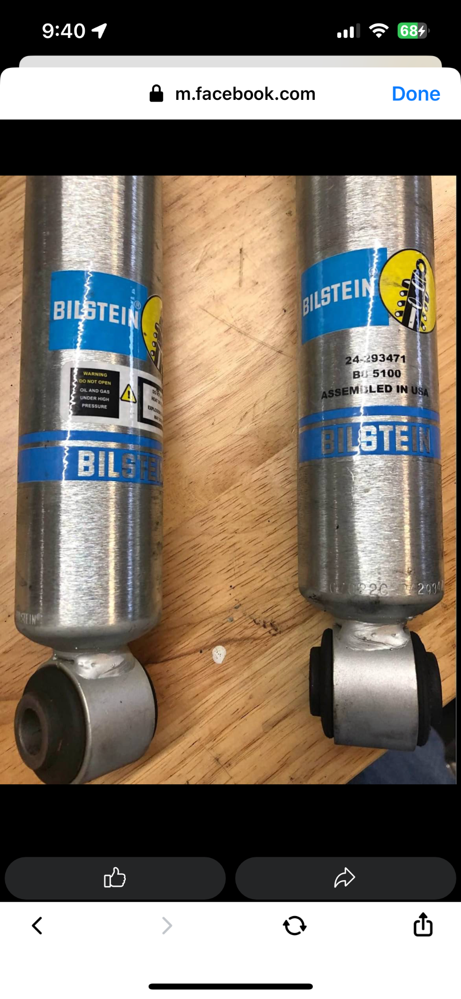

Part # for 19-23's Non trail boss are these
Fronts - 24-293297
Rears - 24-293471
That’s what I thought, but I was wondering if anyone had tried installing these on their truck. I’m about to put part number 24-293471 on the rear. They were supposed to be for a 2019 but they came off a 22 GMC Sierra.
Edited by Maxine Parks
I also saw that they offered part number 24-309509 as the factory size up to a 1.75 lift. The price for the whole strut assemblies is 50% less than 1 new shock so I’m curious if It would work out 💪
The older generation strut won’t fit the newer truck. 2” short compressed and 4” short extended.
Edited by AJMBLAZER
No.  They aren't the same from 2014-2018 vs the 2019-current trucks.  You need the ones for a 19-current.  Frames are nothing alike.  Those 14-18 struts would probably fit an 07-13 truck, that's about it.
