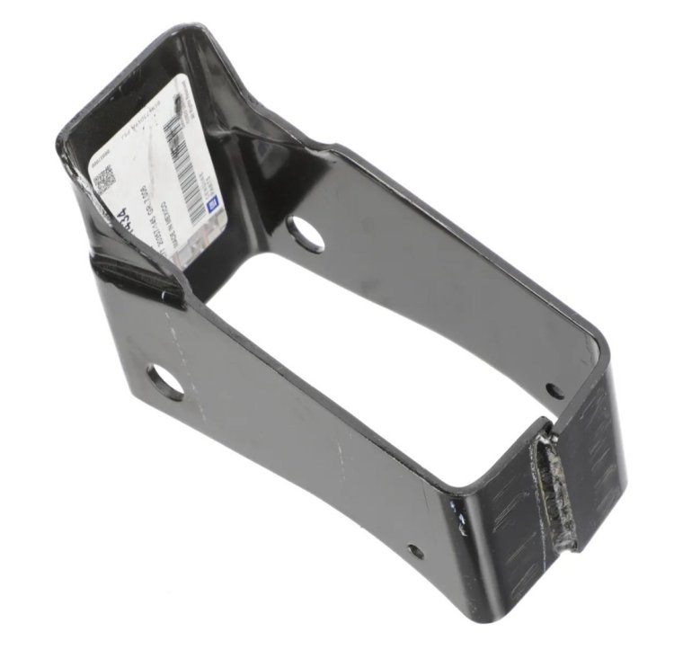

I installed a GM Trailboss 2 inch lift kit on a friend's 2023 Silverado and got everything on exept the frame reinforcement brackets. I could not figure out where they go or what they are for. Any help on where they go on would be appreciated.

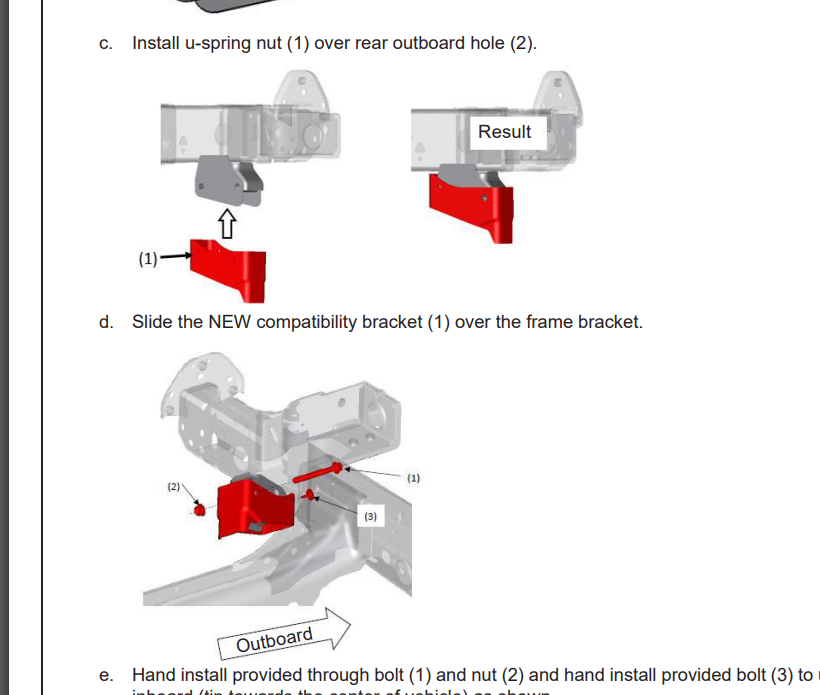

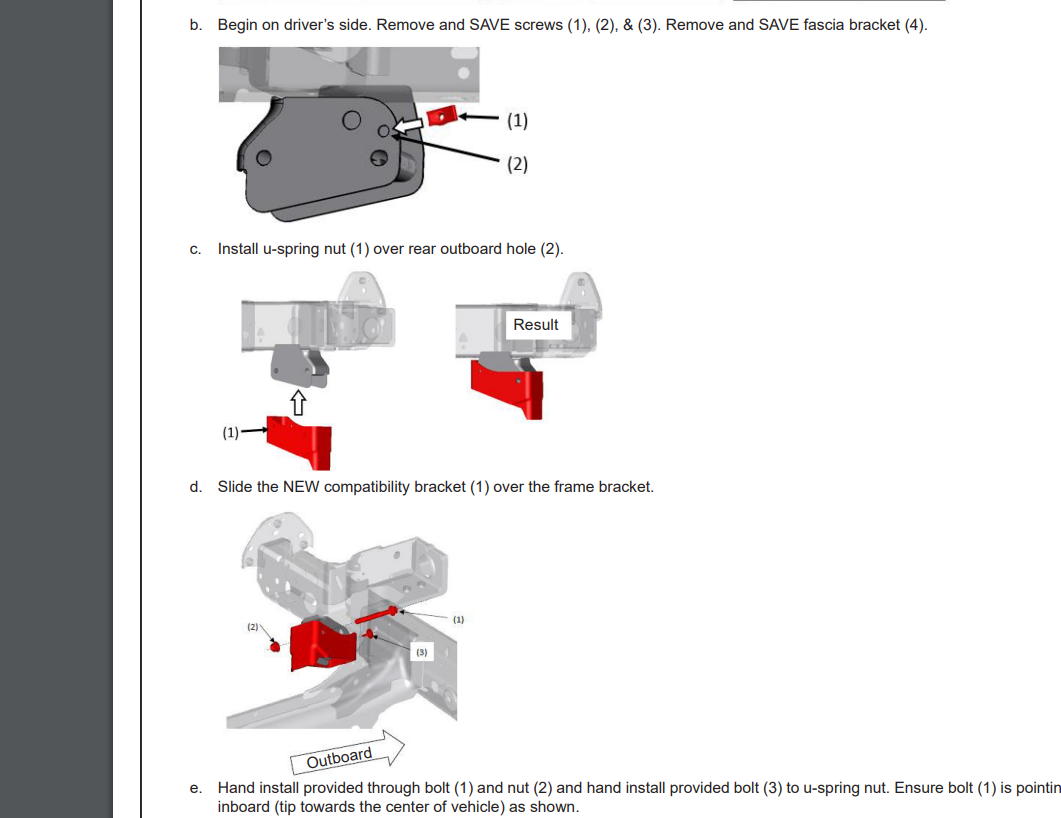

Here's a link to the install instructions.  Looks weird...kind of like a collision bracket to prevent you from running over short vehicles.
https://www.gmpartsgiant.com/resources/installation/gpg/20_isheets_84629788.pdf
image.png.fb2872b1f5f8b4521801c0ac56de7438.pngimage.thumb.png.81fdadf79d32b75b8687e856eba3b7e6.png

Otherwise.....bolt (1) and nut (2) are provided...you could simply measure the diameter/length needed and hit a hardware store.  For #3 you have two options.  One take the provided spring nut (you didn't say you were missing that) to the hardware store and get a bolt that matches in the right length or buy a new spring nut and matching bolt.
You have another option...leave it off.  I'm fairly certain it's intended to prevent overrun during a collision.  Don't rear-end anyone.
image.thumb.png.8c6abedaa830357affa7dced37d35f88.pngt (you
