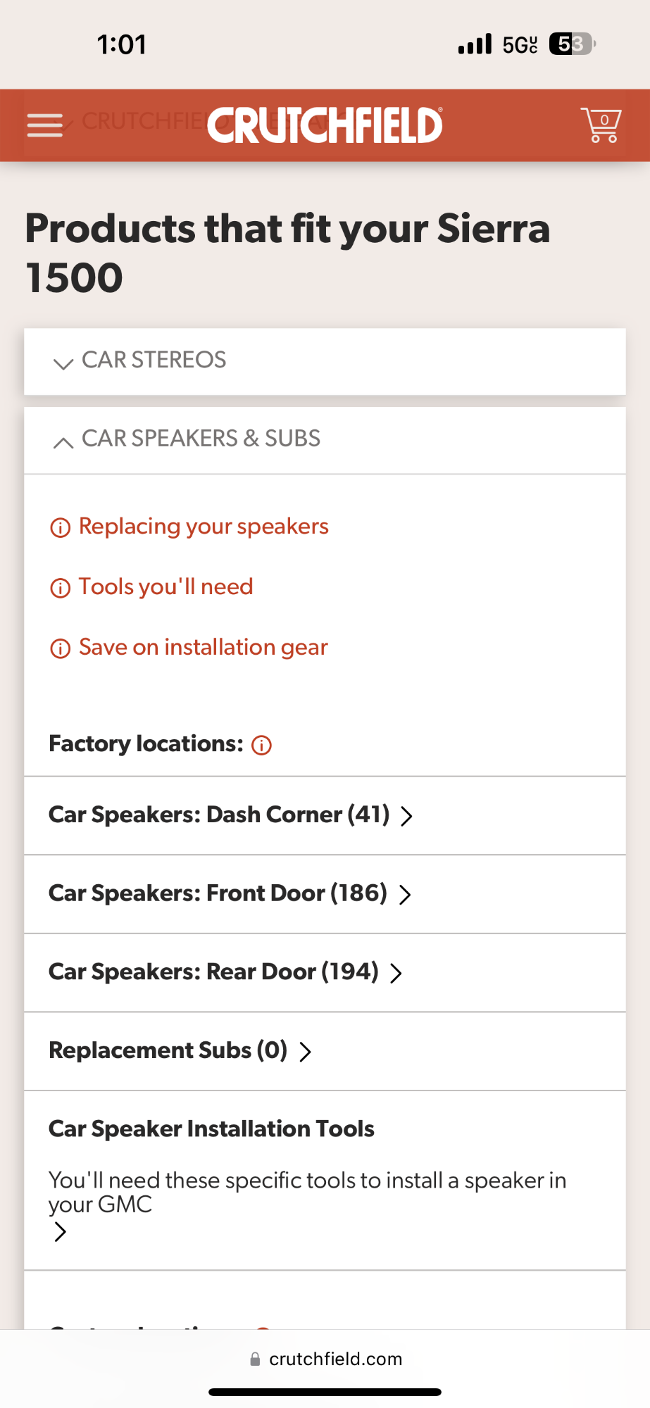

RobT420 Posted February 17, 2024 Posted February 17, 2024 Check out Crutchfield, they’re a pretty good source for info on what audio stuff will work in your vehicle. https://www.crutchfield.com/car/outfitmycar/mycar.aspx 1

Vincej138 Posted February 28, 2024 Posted February 28, 2024 11 hours ago, Bikerjon said: What brand of speakers from Crutchfield did you get? Did you just do front and rear door speakers? I did something similar, I'm just lazy and have not installed them yet. Along with a list of other stuff sitting in the garage. But this is what I grabbed Dash - Pioneer TA-A709's Front Door - Kenwood KFC-6966S Rear Door - Kenwood KFC-1796PS Then all the harnesses and mounts 1
