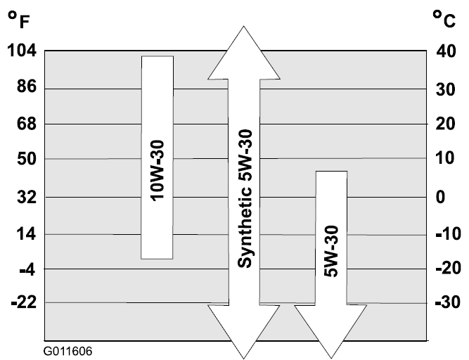

My snow blower calls for 5W30 synthetic, been using Castrol. I have 5W20 Amsoil OE for our Hyundai.
Will the Amsoil OE work in it?
I would not run *W20 in an air-cooled motor. Especially one that works as hard as a snowblower. YMMV.

Yes the Amsoil OE 5w30 will work fine in the snow blower. I have repaired a Husquvarna with Tecumseh 10 HP for a neighbor and ran RLI BIOSYN 5w20 for cleaning up then changed to Mobil synthetic 5w30 that is DEXOS 3 and a lot like the Amsoil OE 5w30 and its working fine.
I agree with Grumpy to be careful with using automotive oils in air cooled engines.  My favorite SAE30W or 10w30 for air cooled engines is the  image.png.b231104c3c2cfb6f1ea5ba1a3d6c4aa5.png
I would not use the 5w-20. Now AMSOIL’s ASE 10w-30 would work great. It’s designed for small engines.
What engine is on it? The Amsoil should be fine, it's not likely to be out in warm temps that would require the 10w30. Some air cooled engines use a splash oiling system and require non detergent to keep the foaming down but where the recommended is a synthetic the viscosity shouldn't be a problem
It's not going to give a crap if you use 5W20 instead of 5W30. I'll pay for a new snowblower if it blows up.
I run whatever is in my cabinet in my lawn mowers and snow blowers, if for some reason they need to be topped off with oil. Never had one blow up on me.
I've got an old 1997 MTD snow blower, calls for 10W30, the Toro mower calls for 5W30, both get whatever is laying around.

Thanks for the opinions guys. I was trying to avoid another oil on the shelf and ordering another Amsoil product, but this Toro snowblower was $1700 new. This last storm it got worked really hard so was thinking of using Amsoil.
I had $15 in rewards from Amsoil so I ordered 5W30 small engine oil.
