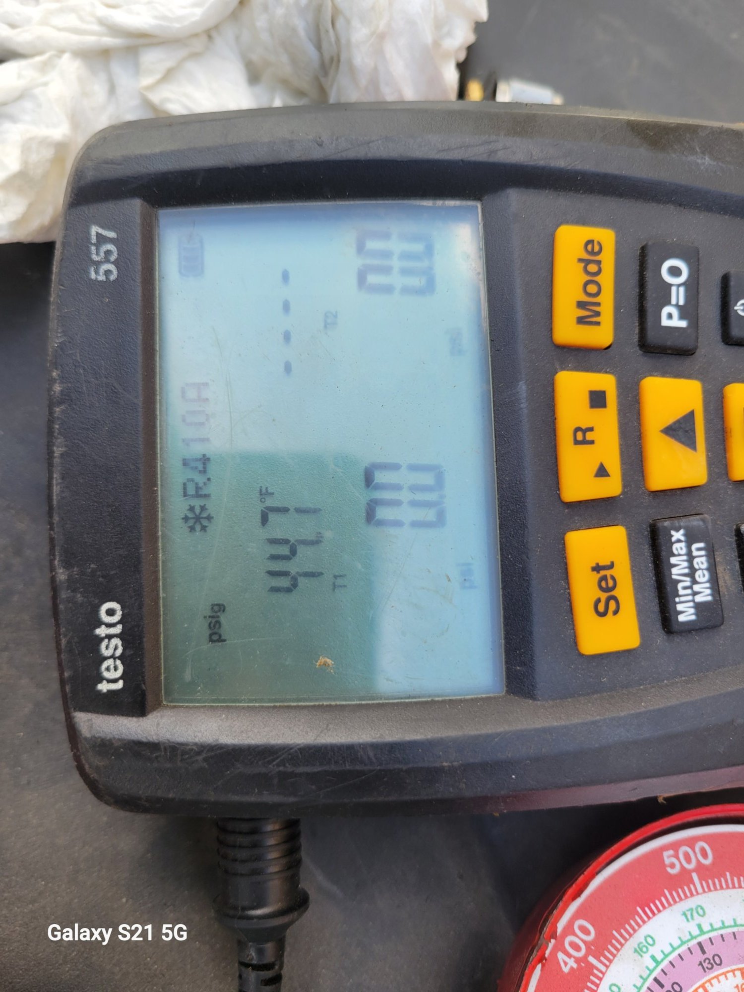

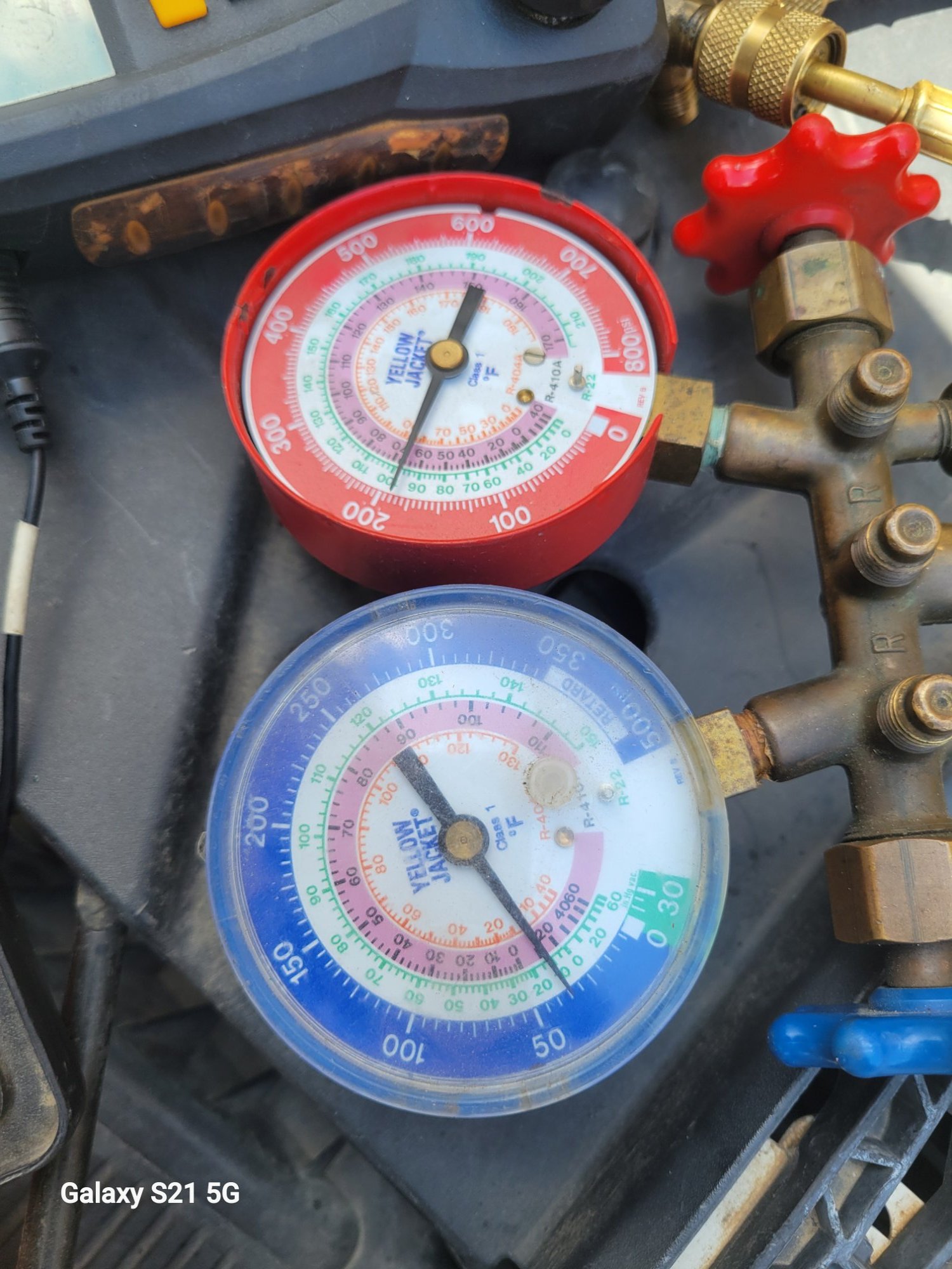

Here are my pressures for today. I used an old blower from a residential Furnace to blow air across the condenser. The truck fans came on at a low speed then medium. Never made it to high speed.Do not mind the two different gauges. The analog are my backup. Vent temp is noted on the first pic, suction line temp on the second.
