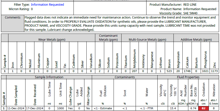

A VOA of Red Line HP Euro Spec 5W40
Some Assembly Required
I always start with the Hersey number and the Stribeck Curve. Because that is the starting point. Viscosity. Speed and load are built in to the vehicle and the right foot. Viscosity is what is left. Every additive in the add package is SUPPORT SYSTEM and that fact escapes allot of people.
Viscosity used to be a base oil property. The property the Hersey Number has it's roots in. Used to be and should be, because a truly Newtonian Fluids viscosity isn't subject to changing based on shear or shear stress. Only on temperature.
I work with what I have access to and true performance straight weight oils are history. So what is the 'next best' solution? I'll leave the boredom of history to your research and others.
Next best solution is a base oil with a very large viscosity index. If that is possible then ever smaller amounts of VI Improvers, VM's, are required and the smaller the volume the smaller the impact when they do what they do. Break down. It's what polymers do. There is also the VM Polymer quality and stability to look at and the most stable polymers are rarely used in OEM spec oils. But they do exist and are used in more costly boutique oils. Sometimes called 0-5 SSI polymers or 'Star Polymers'. SSI stands for Shear Stability Index. That would be the ASTM D6278 test and good luck getting those results from those that use the cheap stuff. It is hideous how unstable they are. Which brings me to my first point. Why I choose to use a higher SAE viscosity grade.
Because I know that Wally World oils of OEM spec and API certifications are actually only the SAE grade they say they are under the least severe conditions of the basic ASTM D445 conditions and are obscured by the change in reporting methods under the HTHS ASTM D5481 test that report in cP instead of cSt. The density adjustment is killer. In other words I have to start with way more than I think I need to get "In Operation" the value the machine demands to good Hersey Driven wear protection.
So there isn't a single base oil that will provide both the required viscosity AND the required Viscosity Index as a stand alone in anything above a SAE *W20 and that isn't heavy enough to get the heavy lift of a million miles done. Much less protect from process upsets...which brings me to the second reason for my viscosity choice.
The OEM has, if any work is done beyond following the company EPA mandate at all, provides only protection for "Normal Operating Conditions". The days of Engineering use of a "hefty safety margin' is gone. But multiple ways viscosity can be compromised is growing in leaps and bounds. Start with fuel dilution of GDI and failed GDI pump seals that go undetected for tens of thousands of mile when there isn't any UOA protocols.
That means target value must be reached in blending bases. Bar Bell Blends provide a wide viscosity envelope. High VI stacked on high VI.
This can not be done with Group III's in anything above a SAE *W20. Ring a bell? Group III bases have a very limited and very low natural viscosity but a pretty good VI which means the go much lower than mineral oils giving cold start protections but fail to deliver hot work protections and you can't bar bell what you don't have.
That job is left to either Group II's for most of the SAE range OR m-PAO's and Esters. Why Lake loves his mPOA's. A little 100 vis goes a long way, and pure PAO blends are so non-polar it can't be added to any great extent. Both of these better bases and not allowed in the read across.
Esters provide both film and polarity. Addition of AN hinders oxidation so now the base is beginning to take on some other properties we find useful that will, once again, limit the amount of SUPPORT additives required.
In the above VOA use of such materials limit the volume of VM to under or about 5% or roughly 10% to 15% less that that required in a Group III base set.
Lets do a quick look at the total. PAO/POE/* give a very good natural viscosity, viscosity index and shear stability before any VM is added at all. This blend also provides exceptional Oxidation and Thermal resistance. In some cases better before adds than some Group II/III blends afterwards.
It has a synergy that provides better lubricity than any single component alone can and the same is true, once again of thermal and oxidative resistance. Cleanliness due to polarity is very good as is additive solvency. Look how close you can get to very good without chemicals.
But chemicals indeed will be needed. WHY? Because every ounce of advantage this blend brings to the table is offset by the OEM's control strategies of using killer heat and ever lower velocity. Hersey again. Big loads, (turbo on small motors), low cruising rpm and hotter than a BBQ pit and we have extended the OCI yet.
I'll work on the adds in the next post. As good as this fluid is, it isn't perfect. No ones is. But we can get close.....
Late Note: VM are the fastest thing to break down in any oil formulation.
Elemental sulfur is in everything. It's in the detergent (Ca, Mg) and it's in the AW package (ZDDP/ZDTP), it's in the moly and sulphonated ash is under attack. These two packages are tied together. The AW package is not just a good at wear control but a MAJOR contributor as an antioxidant. Pull back on ZDDP and detergent at the same time and the oil does not last as long. TBN crashes. TAN increases if esters are in play.
The rush to Group III and higher base oils and their synergies was a partial cure so oils with large contents of Group II and lower chemistries were getting left behind. Unable to make the spec is some cases. But like always, the increase in oxidation resistance offered by the improved bases was largely offset by operating conditions as noted earlier and complicated by a reduction on SAPS.
There is also a competition between the AW and the Detergent package on active surfaces and polar oils like that space too.
This idea that oils have advanced and are far superior is half smoke and all mirrors. Not that some don't exist, just not a mortal can get his hands on nor are approved by the OEMs and the API for licensing.
And still not the full story. RING seal is the elephant in the room. If they seal the mater doesn't matter. Poison that hasn't asceses to the Cat's poisons nothing. Low tension rings with DLH faces are still hit and miss in oil control and cylinder seal. Get it right and it's a beautiful thing. Get it wrong and disaster. As the later is more common than the former they crutch the oil to get it past emissions warranty. It's a mess.
In the example under assembly the blender has reduced both calcium and phosphorus and added back next to nothing for Magnesium. Added some boundary chemistry, Moly and a good dose of EP additive, Boron.
By lowering the Ca it makes the Zinc/Phos package more available. In part why I prefer the Euro blend in the HP series is this feature. Although this example is 'suggested' for Porsche C40 (mid saps service) it actually straddled MID and Full Saps. As my rings seal I haven't a worry nor a dog in that fight. I actually add a bit more ZDDP to tip it into the Full SAP arena. That addition increases oxidation resistance making an oil with a lower TBN act as if it were heartier.
Moly also contains some sulfur and you would see in earlier versions of these oils a bit more Moly and allot less boron. The trade was a good one.
I'm not selling or promoting this oil. I'm showing an example of an oil I have history with, experience with and took the time to stick with to learn what it is I know. I could have done the same with any other oil that gave me the access Red Line did. So let's stay on point and focus on the additives and the synergies between them and the base oil selections.
It's a lot of moving parts and it takes time and lab work to fret out and it isn't for everyone.
Any top boutique blender COULD do this sort of thing but a few are relenting to the pressure from an uniformed public to compromise. That does not mean you give up. It means you may wish to modify your choice. Modify your expectations for longevity of the oil. You can't continue to remove all the chemistry that prevents wear and long service life and keep the same maintenance intervals.
BITOG has a pretty large VOA data base. Some current and some older. A tool nonetheless. One of the bigger eyeopeners was oxidation levels of various oils. Anyway...enough for tonight.
Edited by Grumpy Bear

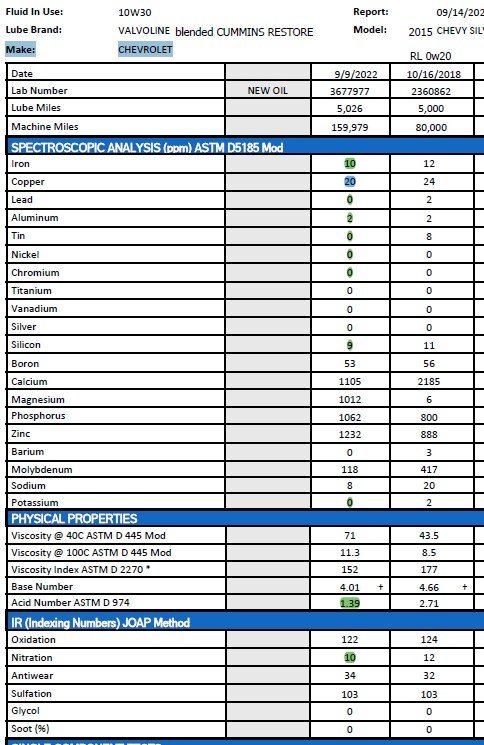

We know that Cummins Valvoline Premium Blue Restore 10W30 clocks in oxidation between 109 and 140. ( I have 3 separate reports) That's a real cleaner and a point toward what it takes to get an Aniline point in the cleaning range.
We have the other end of the scale pinned down by Lake Speed Jr. at an oxidation value of 30 as a minimum which I assume means minimum to be effective as a prophylactic. ( I base this on his earlier works siting a value of 25 now revised upward ). I like his flexibility and willingness to course correct as he learns.
Use of AN's and other polar materials will not permit a straight across Aniline to Oxidation correlation but again, directionally it would be easy enough to make the case than a fully formulated PCMO with an 80 to 120 oxidation to be more aggressive than a 30 to 40 oxidation.
And to that point scrounging around in the data base I find PCMO's grouped into some pretty distinct segments with a few gems emerging.
Most Full Synthetics fall below even 10 oxidation. Mobil 1 ESP formulations and HPL various fall in that 30'ish area. AMSOIL in the 45  range. And while not in this data base Red Line is clocking in between 80 and 124 or just below the CUMMINS product. Compare below CUMMINS and Red Line HP at the same UOA intervals on oxidation only. Note sample one submitted earlier above. Focus.
