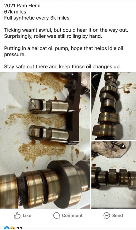

It’s from Facebook so probably a big “if”…but “if” this guy is telling the truth about the oil change interval, that leaves the quality of the oil used, and the viscosity of said oil as two big question marks here. Even the non-wiped lobes on the cam look terrible.
Not saying every truck is eating a cam at 67k miles but I’ve seen enough low mileage failure cases to be highly skeptical of generic 0w20 being run in any full size trucks.

This is what you were seeing in Your analysis when I saw it earlier. How’s the reports now?

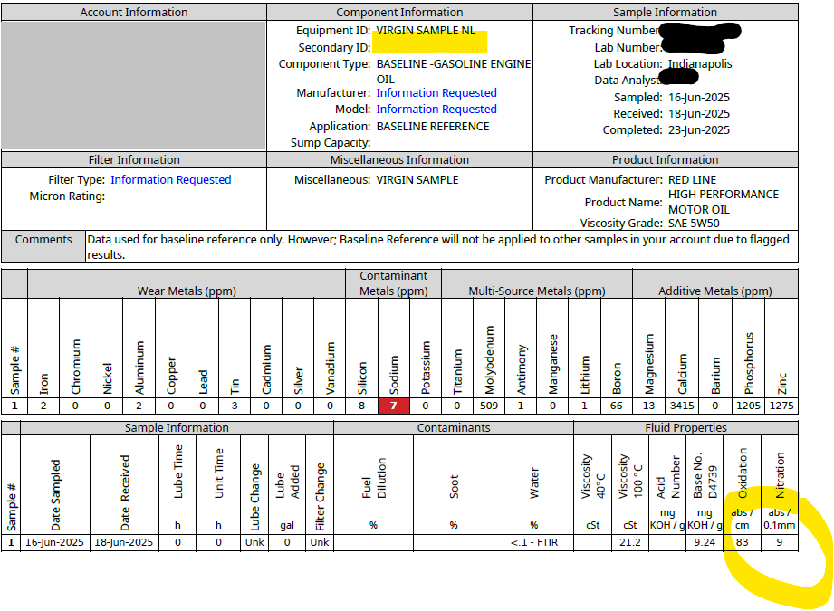

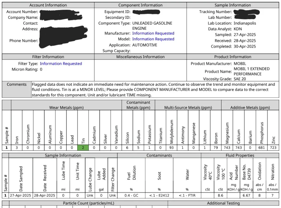

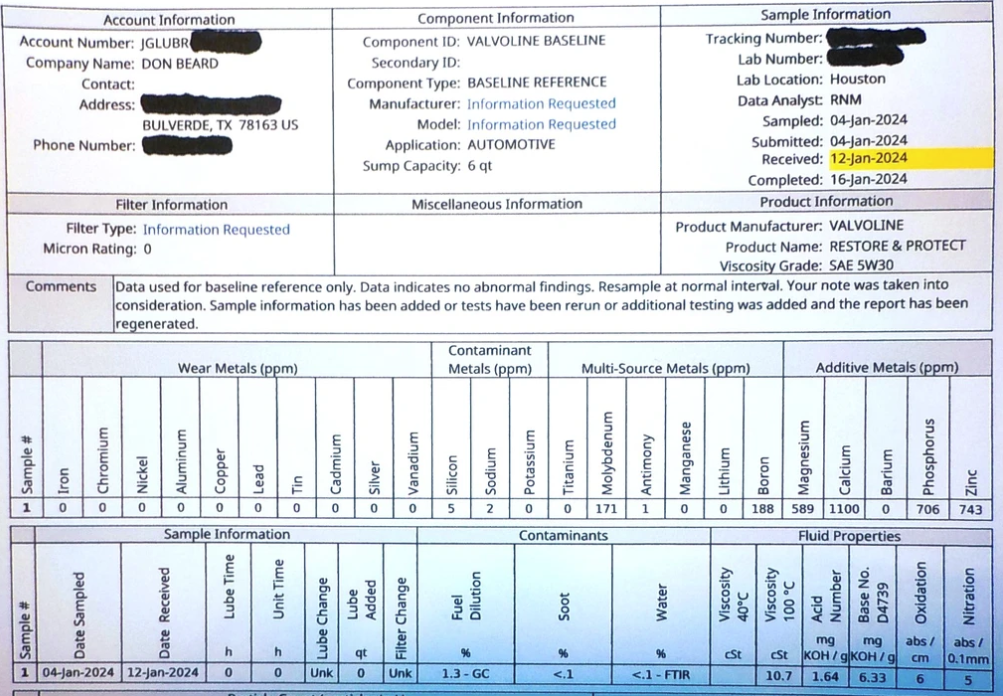

Improvement with miles just as one would expect. Oxidation and Nitration look stellar for this oil which has nearly a 10 nitration background. Oxidation, ditto, near VOA values. Good VI retention. TBN is happy on E85 and begging for some breathing room. Oil is not being stressed. Fuels is what I would expect for the fuel used vs the fuel that was. Identical to my results.

Boys we aren’t making meth or spraying nitrogen on fields. No engine oil
has 10 abs units of nitration reading. You are nuts.
1 hour ago, Grumpy Bear said:
Once again catch you “skinning the cat of truth”. Firmly call you on your online BS. THAT ain’t  10 abs. So you are an order of magnitude off. Geebus
I've supplied numerous STLE and SAE articles and equipment vendors instructions on this topic. You can't wish a thing to be true. I'm not suppling more TRUTH from YOUR PEOPLE for you to ignore and confuse people with.
Nitration levels are all over the map. 2 minutes googling others VOA samples. Background matters. It matters to the STLE and the SAE and to the people that make the instruments that measure it. You call me a liar and a fool and whatever else come to mind but it still won't make you right. Make you opposed to your own craft.
Produce ONE single credible source that agrees with this fiction and I'll give it a second look. But until then...fiction it is.
