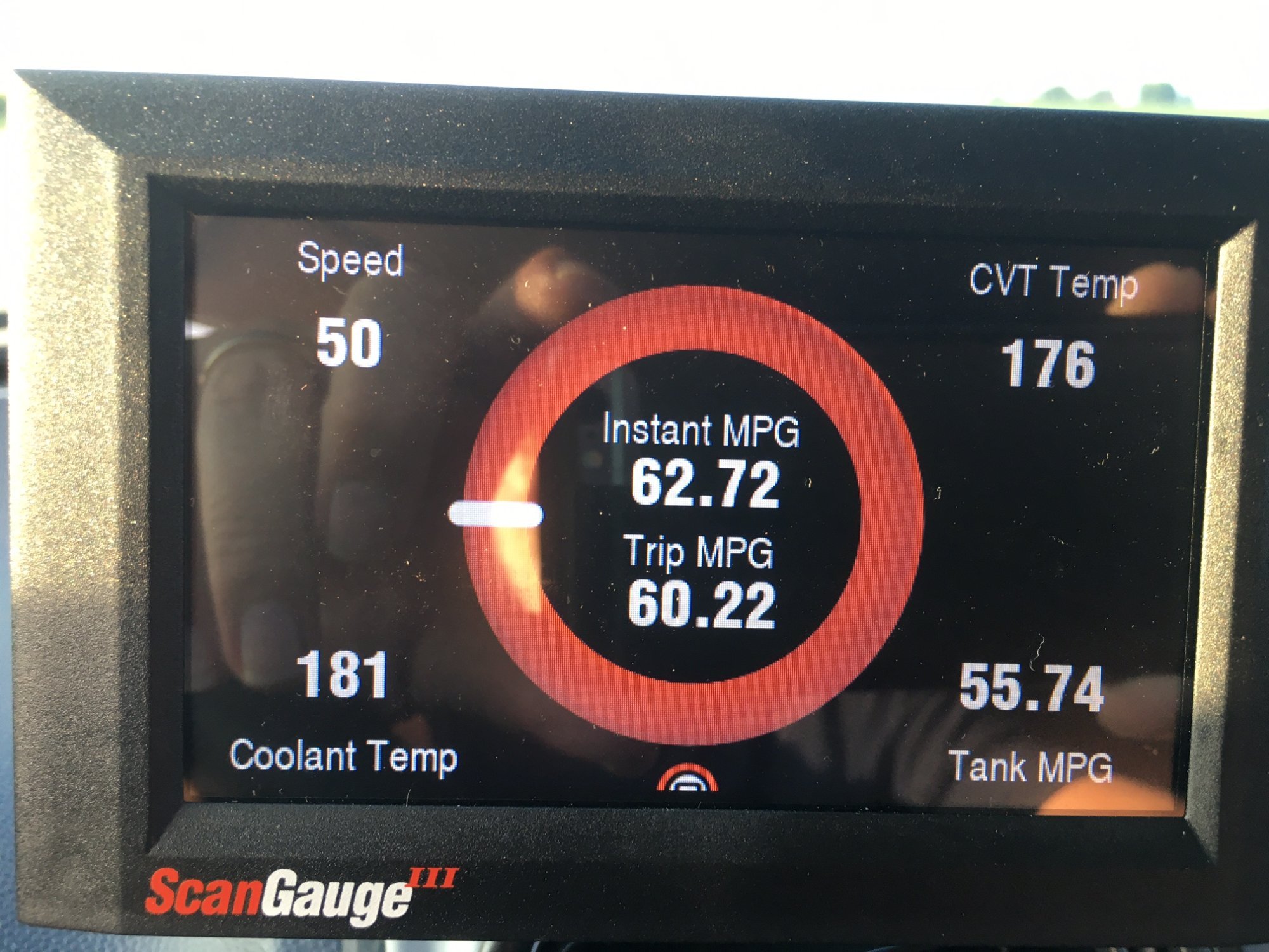

How much Assembly is Required?
So I finally got a fluid temp gauge installed on the CVT in Raven. Some others in the Mirage Forum I'm in have had them for awhile using a different application and device. I've spent enough on that sort of thing. OMG do these things run hot!!
So the CEL gets tossed at about 258 F and goes into limp mode at 265 F. That's factory. Factory is also a Group II/III blend fluid and 87 C thermostat and not real fluid cooler. More of a fluid heater, attemperator.
Some of these guys, living southern US are running 80+ and towing with a vehicle that has zero towing capacity. Even have a member who went into limp mode on the drive home breaking her in at 85 mph. Lord help that poor car. Seems Joe Average who monitors this parameter is steady over 225 F even in Canada. One member has installed a trans cooler and with a more moderate set of habits his his under 200 F...just. Others in the South West US shudder to look. 230 to 250 F desert crossings.
And we have a power train engineer that has worked for three major Asian auto makers telling us they are set up to die by 150 K. No cooler, mineral oil, no direction or guidance. Not dash monitoring other than an OH CRAP CEL.  Long drain intervals. Internal fluid decay monitoring to deny warranty claims. Resettable only by the factory tool. Stupid expensive maintenance cost.
I'm not listing all I've done to work this out but in my day to day I'm under 185 F and haven't installed a cooler yet. But it's coming. I'll get it under 175 F on my worst day before I'm done. And I'll get what I always get. A long trouble free service life with few limitations.
Fluid life and a factory OCI of 30K with temps routinely over 225F
:idiot:
Russian Roulette anyone?
Parts is parts. CVT or conventional, all have converters, clutches, valve bodies and seals and the fluid has no idea what machine it is in.

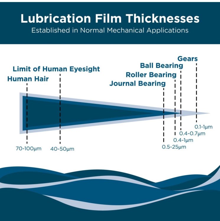

It's a long read and requires a good mental filter but worth the nuggets of gold buried within if you can:
Do Some Required Assembly
https://www.stle.org/images/pdf/STLE_ORG/BOK/OM_OA/Additives/Special Additive Report_Viscosity Index Improvers_tlt article_Sept11.pdf
[Snippet] Placek believes that the added performance requirements for a VI improver in lower-viscosity engine oil may lead to the need to shift to a higher-performing polymer. “Some concern has been expressed about a loss of hydrodynamic lubrication that may accompany the use of lower viscosity oils for improved fuel efficiency,” Placek says. “If high-performance VI improvers can help maintain equipment durability while also delivering improved fuel efficiency, then there could be a shift to higher performance VI improvers for engine oils in the future. [End quote]
I will say this…we really don’t necessarily need higher performing polymers, we just need more MOFT, and there’s other/better ways to get there.
  • Thanks 1
A 0W20 or even a 5W20 can be made with a HTHS over 3.0. MTP30K, Red Line HP, Evolve EvoSyn 5W20 to name three.
