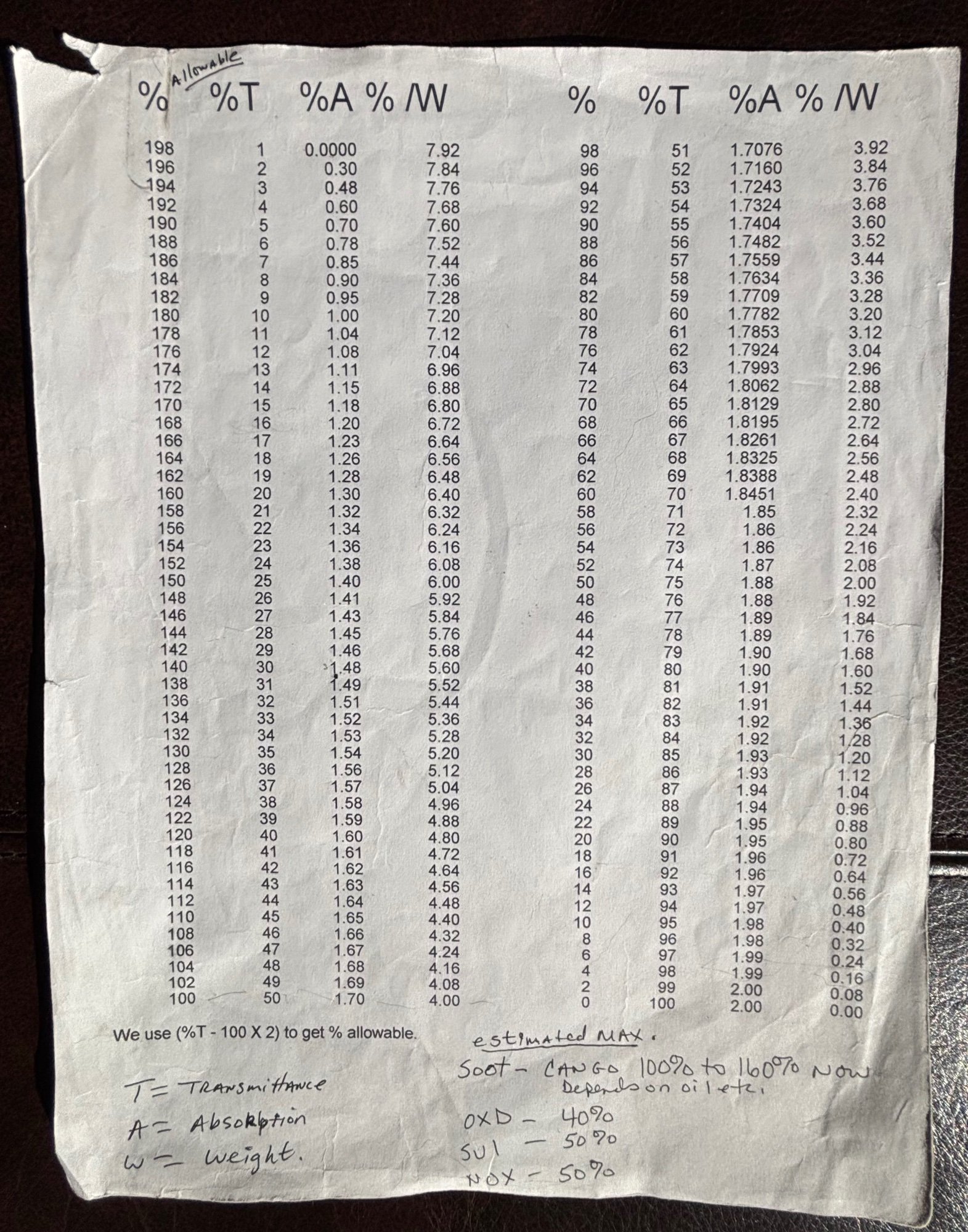

I did this chart with a friend/ colleague from CAT labs when they used Perkin Elmer machines in 1998-99. It gives @Grumpy Bear and @OnTheReel a comparison of values. SOS CAT labs have gone south on reporting good FTIR data and my pal is dead.
Explain please the notes on the bottom right column.

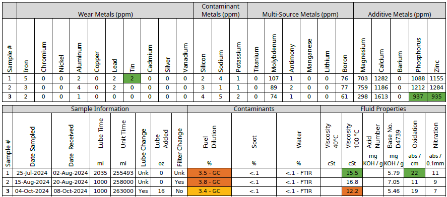

Rewind the Assembly
A recent post noted upping the viscosity wouldn't hurt anything, it just isn't necessary.
Lets remember point of reference. "As things ought be". And in that case and situationally dependent I might be inclined to agree, especially in the case of Dizzy whose OEM call out is 5W30.
So why did I up the ante? Because Dizzy isn't operating as she ought. She's operating 'As she is" and that is with a profound amount of fuel dilution that has no remedy other than a rebuild. Early by reason of a faulty high pressure fuel pump and afterwards as a result of the loss of ring seal. Something not abnormal to the Ecotec I-4 engine series.
In other words I went to 5W40 to get a 5W30 under current operational conditions for which there is no economic fix. Also because the design has the fuel pump, prone to failure, with access to the crankcase and thus the oil. Upping the viscosity is insurance for the inevitable engine killing pump leak.
Why the ultra short OCI's? Again ring seal caused dilution. Fuel doesn't just kill viscosity, it kills lubricity and both increase wear rates. It also accelerates oil degradation.
First sample is Mobil 1 HM 15W50. Ending as a SAE 40 with elevated oxidation at 2K miles with pretty good wear.
Second sample is that same oil at 1K miles sill in grade with improved oxidation. Cleaner.
Last sample is Traveler's SAE 40 Mineral oil with ZDP added, which ended in 1K miles as a heavy SAE 30 and wear is stellar. New fuel pump installed with injector service at 261,753 miles which you see had zero impact on dilution. RINGS.
Both too heavy for year around so I settled on Mobil 1 Euro Spec 5W40. So at this point the short OCI is to keep the ring land oil returns open. Cat is shot and I'm setting a P420 code every day now and using a quart over 2000 miles based on usage in 1K miles. Tis her life until I give up.
