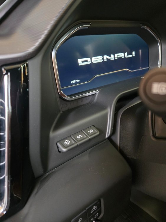

Have you tried adjusting the brightness and positioning? The switches are to the left side of the steering wheel, 3 of them. Selection, Position and Brightness.

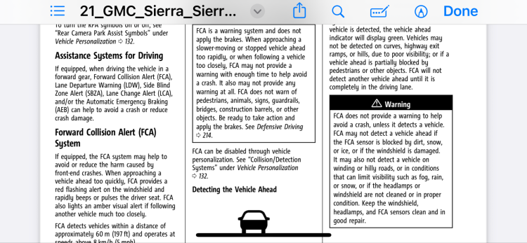

If it has FCA, but not HUD it will have a 'slot' in the dash so it can project the warning for collision alert.
If it does have HUD the projector is larger (more like a square or rectangle) and it has the buttons on the dash.
There is a section in the manual about FCA.
for 2022 2500
(I think they may have changed the 'without HUD display' on later HD's

I downloaded the manual from the GMC site and saved it as a file on my phone shortly after buying the truck. I end up referring to it surprisingly often to remind myself how some feature works.
