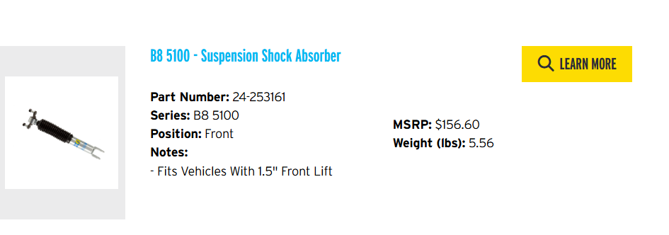

What are the part numbers everyone has used for the bilsteins? I can't find anything for the front of stock height trucks.

46 minutes ago, XY74 said:
I used the part numbers off the Bilstein website.  Looks like I bought them from the Borg.  (amazon)
24-196437  front  24-196444  rear   4600 series
https://bilstein.com/en-us/products/
Ah ok, I see you used the 4600 series.  Someone else above mentioned the 5100 series so that's what I was looking for.  Glad the 4600 series still has an improvement though.
Edited by AndrewF
