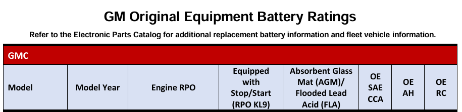

I have a 2020 and replaced at the 4-year point. The dealer installed GM part number 88864542. I'm not sure what H6 or H7 means.
The specifications are linked below.
https://parts.gmparts.com/product/acdelco-gold-36-month-warranty-agm-bci-group-94r-battery-88864542?srsltid=AfmBOopH2-KrPLWmi5SI3pBH4Giimd_eRJLSCDs66BGlINGY6TKHOAxW
It appears that the battery you linked is groups size 94r which is basically the same as H7. Not sure why there are different size classifications for batteries but at least I can cross reference them easily.
