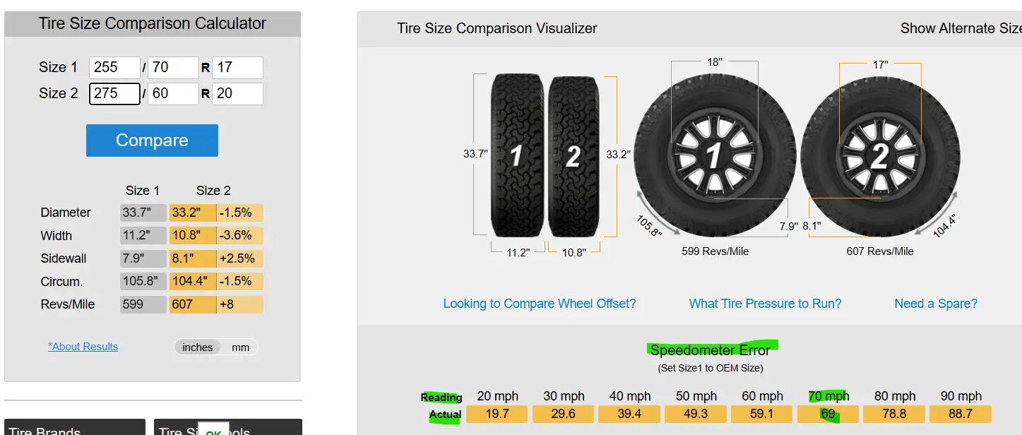

'Tire calculator' shows only 1 mph difference at 70 mph
Bigger diameter rim, but shorter sidewall ratio resulting in similar overall diameter.
With deflected sidewalls give revs per mile 599 changed to 607 or 1.3%
(607-599) /  599 x100% = 1.3%
I'm thinking there is no need to be concerned about the small difference(s) between the two tires
I got around 31” vs 33” diameter for the oem vs. the 275/60 20s that’s a 4mph  error at 65 with actual speed being 69ish.

On 4/23/2025 at 7:46 AM, silveradosid said:
something wrong with that calculator, 255/70r17 is 30.9 inches
Agreed.  a 275/60R20 will be about 2" taller.
I think the "COMPARE" button was not pressed when the 20" tire was entered.  If you look at the right side of the picture where the tires are compared, it is comparing an 18" tire to a 17" tire.
