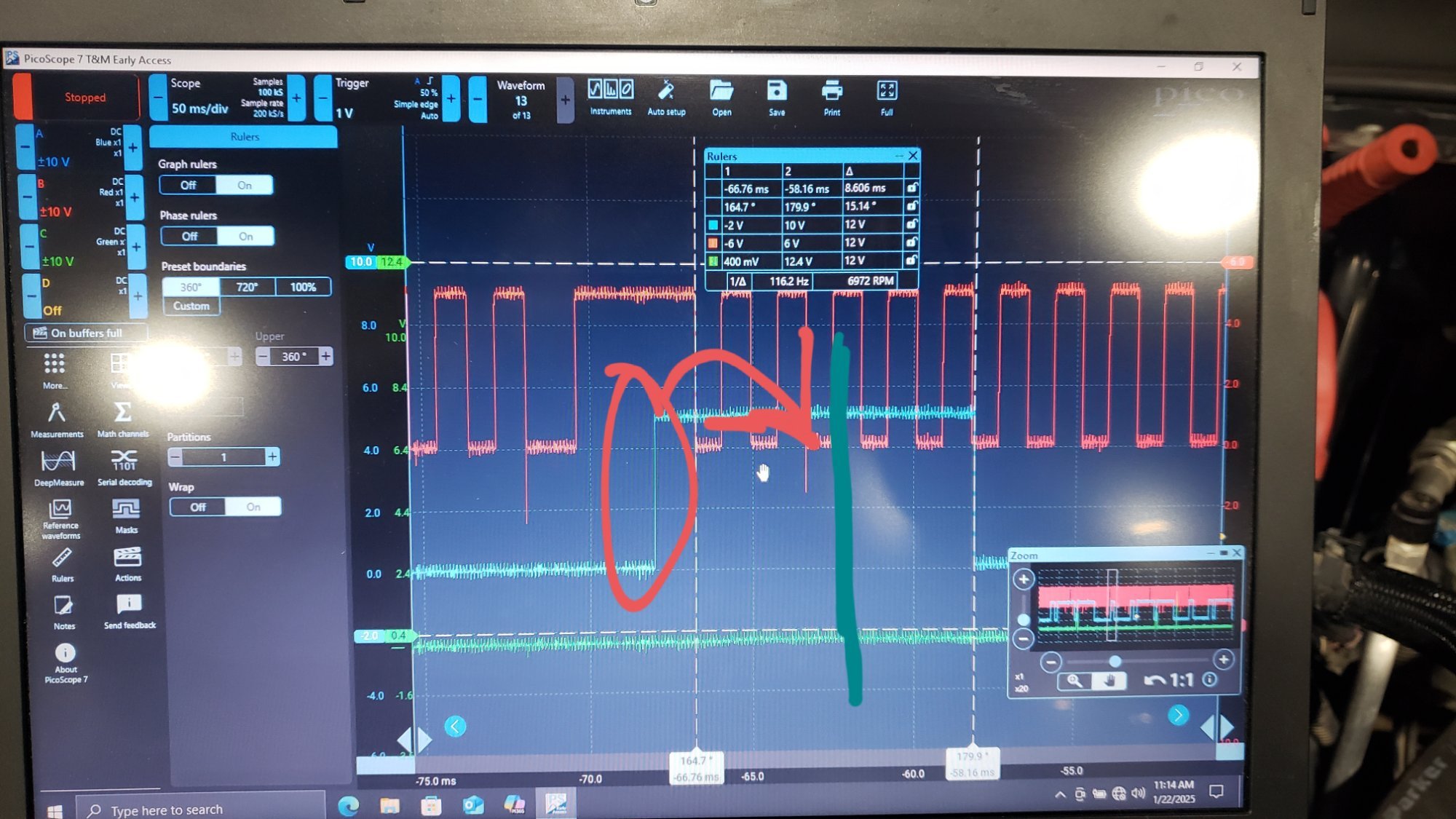

Sorry, I gotta chuckle a little bit if they're using software to 'analyze' a scope waveform; especially for a simple cam/ crank correlation. I use a 4425a almost daily (Indy shop) and you can see chain elongation ("stretch") down to the degree if you have a known good to compare to, or just know the pattern for the reluctor(s). The image below is from one I diagnosed earlier this year that WAS setting a P0016 but without any other symptoms (starts and runs fine). This one had actually jumped time (was off by a tooth) and measured in at about 11 degrees retarded; which is the minimum of the code-set criteria. The measured waveform is actually post-repair, but the red and green highlights point to where the blue trace rising edge (cam tooth) was on the truck before the repair. This is a quick and easy test to perform in a shop with even a basic 2-channel scope. I do wonder how they're using this information to determine engine integrity since I thought the result was spinning bearings and ejecting connecting rods.

I hadn't seen your linked file yet, so I wasn't aware of the scope of their testing parameters. Like I mentioned, I just work in an independent repair facility, so the majority of items I'm working on aren't typically warranty or recall items. Anyway, the P0016 is literally 'cam/ crank correlation fault', so you could understand how it could be interpreted in certain instances.
But I see what you're getting at. They're just using the Pico NVH interface to perform an isolated vibration/ knock test basically, and if it falls outside of the passing criteria, then the engine is about to let loose, and P0016 just means its way past well done in this context. I'll have to try it out and measure my brothers rig ('23 Suburban HC) to see if his is about to grenade.
