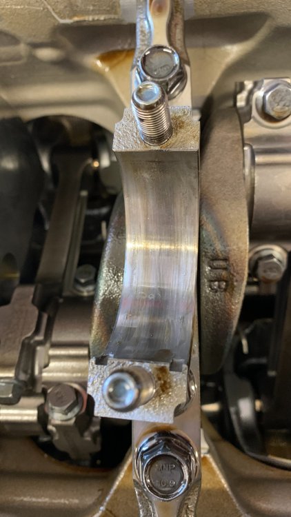

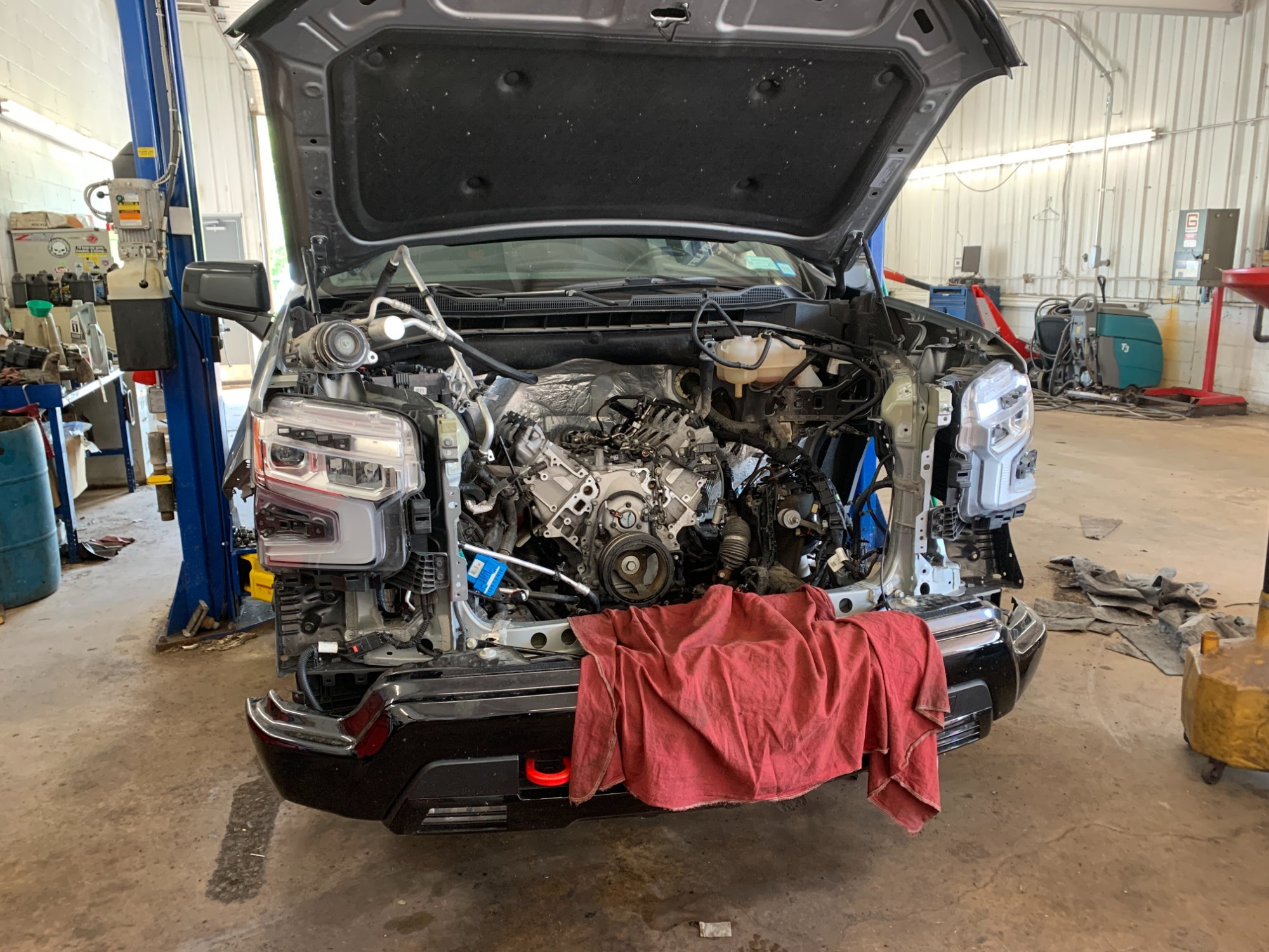

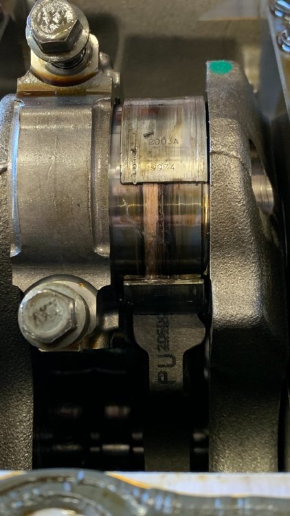

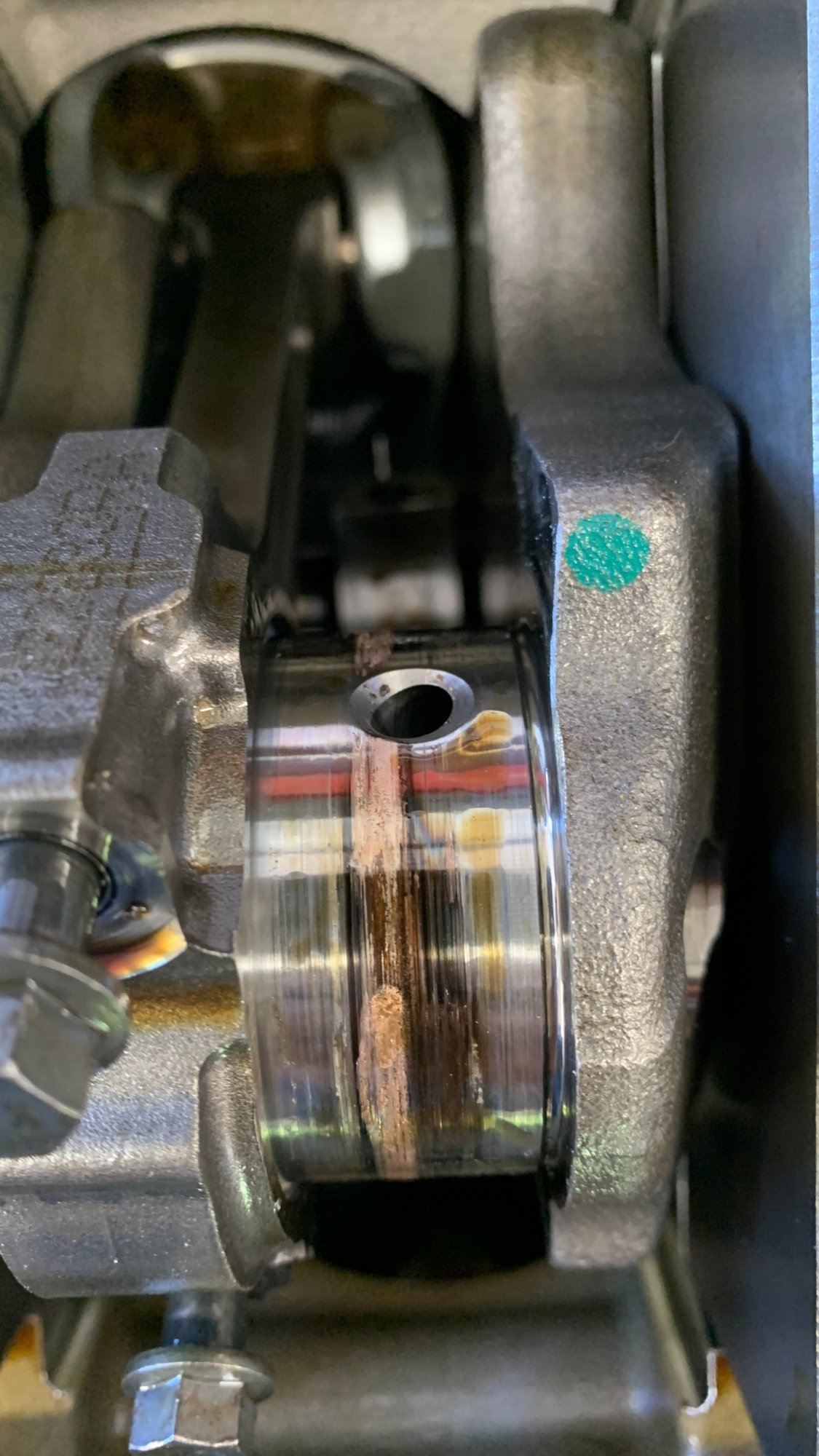

On 8/14/2025 at 5:20 PM, newdude said:
Update to this truck.  Here's a few shots upon damage inspection of the failed engine.
  • Sad 1
This engine would not turn by hand initially and would not crank.  Tech was able to persuade it a bit finally and did get it to bar over by hand but it was a struggle.  Can't wait to see what the one that was towed in looks like.  That recent tow in still runs too, its not seized up completely yet.
