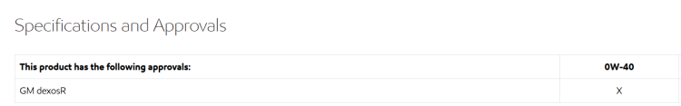

New bulletin/Campaign for '21 -"24 Silverado, Sierra etc with 6.2 L87 engine. Has to do with engine sudden stop (blown). Very early. No parts available at this time. NOT ALL 6.2's are involved. Which ones is unknown. Dealers have a list of inventory to inspect and stop sale if inspection fails. No much of an inspection though. Check for P0016. If it is there then stop sale. If not then change oil and filter to 0-40, change oil fill cap to reflect new oil grade, send it. Again NO PARTS at this time.

31 minutes ago, dieselfan1 said:
Ow40?
WTF?
Corvette/Camaro/Blackwing 6.2 LT1, LT2, LT4 and LT5 use it currently as of 2019.  Nothing new.  0w20 was/is in the pickups solely for fuel economy reasons.

Boy oh boy GM has blinked. Metallurgical issues exacerbated by fuel dilution will only be DELAYED using 0w-40R by Mobil.

Buy enough time until they can get enough engines for full replacement perhaps?  Because I think that's what they might be trying here.  They know they won't be able to meet demand for it so why not stratify it.

It will be interesting to see if they cover past warranty, knowing there was a defect, or is it covered forever if the specific parts fail past warranty?
There is always a better oil option. :)   https://www.amsoil.com/p/amsoil-signature-series-0w-40-100-synthetic-motor-oil-azf/?zo=521390
