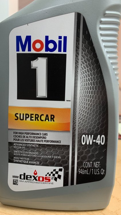

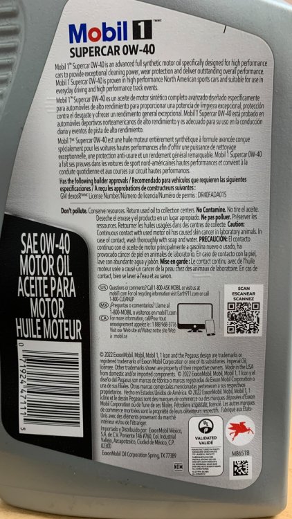

On 4/26/2025 at 8:54 PM, MrLeadFoot said:
How interesting that even the SuperCar formula doesn't mention "dexos R" anywhere on the bottle, front or back, unless I am blind (which is entirely possible).
On 4/26/2025 at 9:44 PM, GETGONE said:
Please note: GM dexos R engine oils meet or exceed the performance of GM dexos 2 and GM dexos 1 Gen 2 and Gen 3 oils and are backward compatible, therefore vehicles equipped with gasoline engines that used GM dexos 2, or GM dexos 1 Gen 2 or Gen 3 may use a GM dexos R licensed engine oil of the appropriate viscosity grade at their next oil change.
On 4/26/2025 at 9:44 PM, Byrds8 said:
Yeah I saw the gmdexos website. But when reading the bottles they don’t even mention dexos or have the emblem.
I thought the Supercar said it. My bad, maybe it doesn’t.  It does have the dexosR emblem on it though.
Bottom left corner of the front.  The Dexos R logo is the "DEXOS" with the red "OS" and the racing flag.
