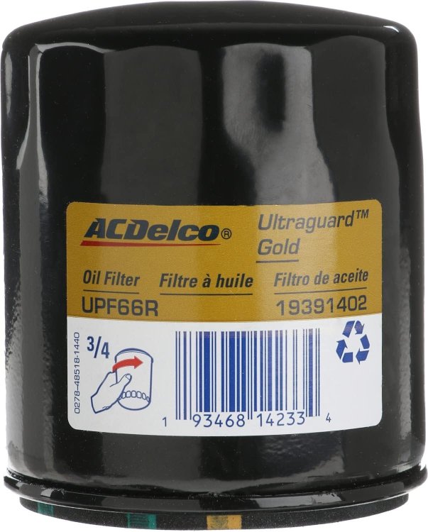

Amsoil apparently doesn't make a filter for a 2025 w/ 3.0 duramax. But they'll sell me a Wix for $9.97 plus shipping off their website.
The Mobil 1 Extended performance filter for the 3.0 claims 99% at 30 microns. Regular price at Advance Auto is $14.99. They sell the ACD PF66 for $11.29, which is outrageous. They're currently $4.78 on Rockauto.

So, guys, safe assumption that middle-of-the-road filters like AcDelco won't give an engine a good chance to hit an average lifespan? Is that the consensus?
BTW, I don't even have an Advance Auto here but it is the first search result that popped up.
Most of my consumables come from a local Napa with actual people who know automotive things that work the counters, or if I need something like carwash soap or brake fluid, the Autozone here is good. Napa will rob you blind, but they're worth it when you have real questions.
In my opinion, go with AC Delco if you want, not because they’re the best, but because they offer good value for the money and are easy to find. These days, it’s harder than ever to say if an engine will outlast the vehicle, but I’m pretty sure very few people drive their cars to the grave, so 20/30 micron differences aren’t all that important in my view. Now, if that keeps you up at night, that’s a different story 🙂 I honestly think people pay way too much attention to what they feed their cars compared to how they treat themselves 🙂
I opine that the AC-Delco filter sets the benchmark for 'average lifespan'. It is, Afterall, the GM touchstone. Legal "Lifetime" of a power train is 150K. If you believe that is 'average'; that Delco will get you there. Likely take it a bit further if all ducks are in a row.
