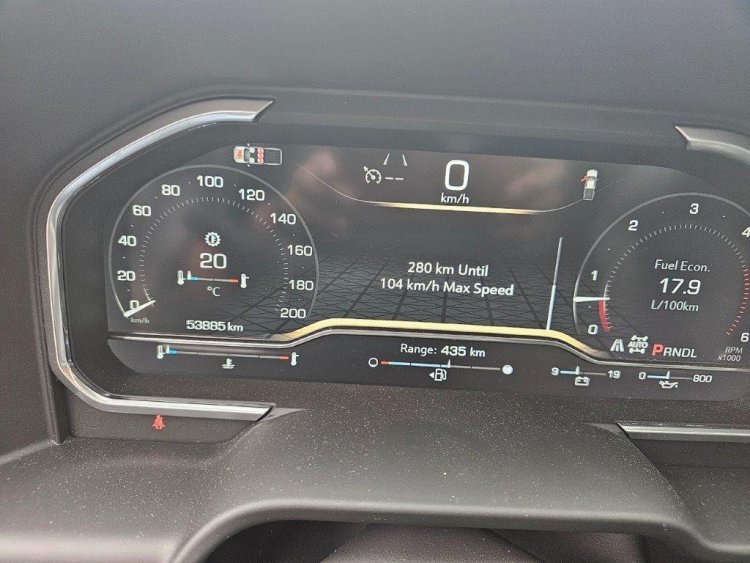

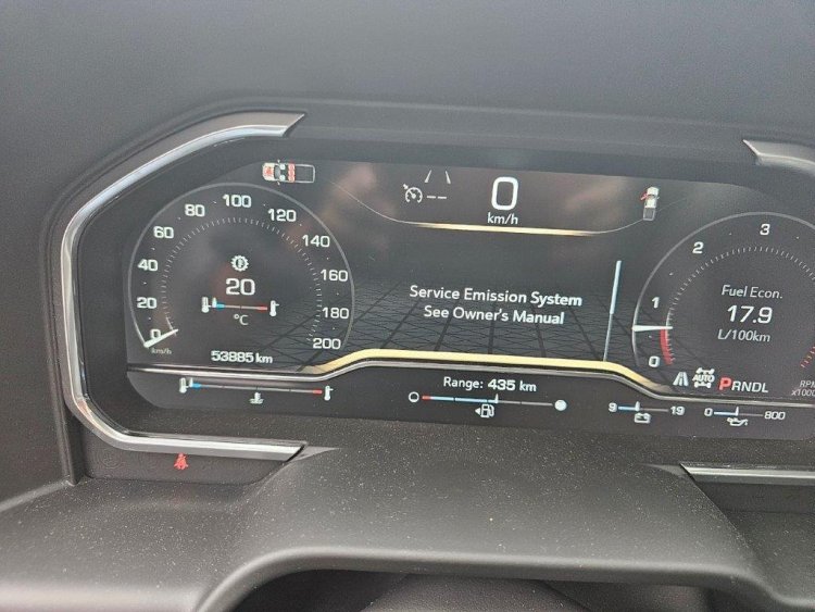

Hey everyone, back in May the check engine light came on and I got the warning in the DIC (pictures attached are from today but it read the same). Took it to the dealer. Tech could not find anything wrong though he did pull 2 codes. All summer it was fine until last week. The check engine light and notice came on for a bit but went out before I could get to the dealer. I have a big road trip planned tomorrow and guess what, it's back. I have noted that this truck pushes blue smoke occasionally when accelerating. Dealer was told last year and they indicated no oil loss between changes. Anyways, I am curious if other members have experienced this. Truck is a 2024 3500 Duramax. Cheers.

I take it on quite a few long trips, plus highway speeds in the lower mainland, so I didn't think it was a regen problem. I got it back today. Error code P122D. They replaced the throttle plate as there were numerous chips on the backside along the sealing edge. Like, WTF, chipped throttle blade? Anyways, glad to have the truck back, but I don't trust it yet.
