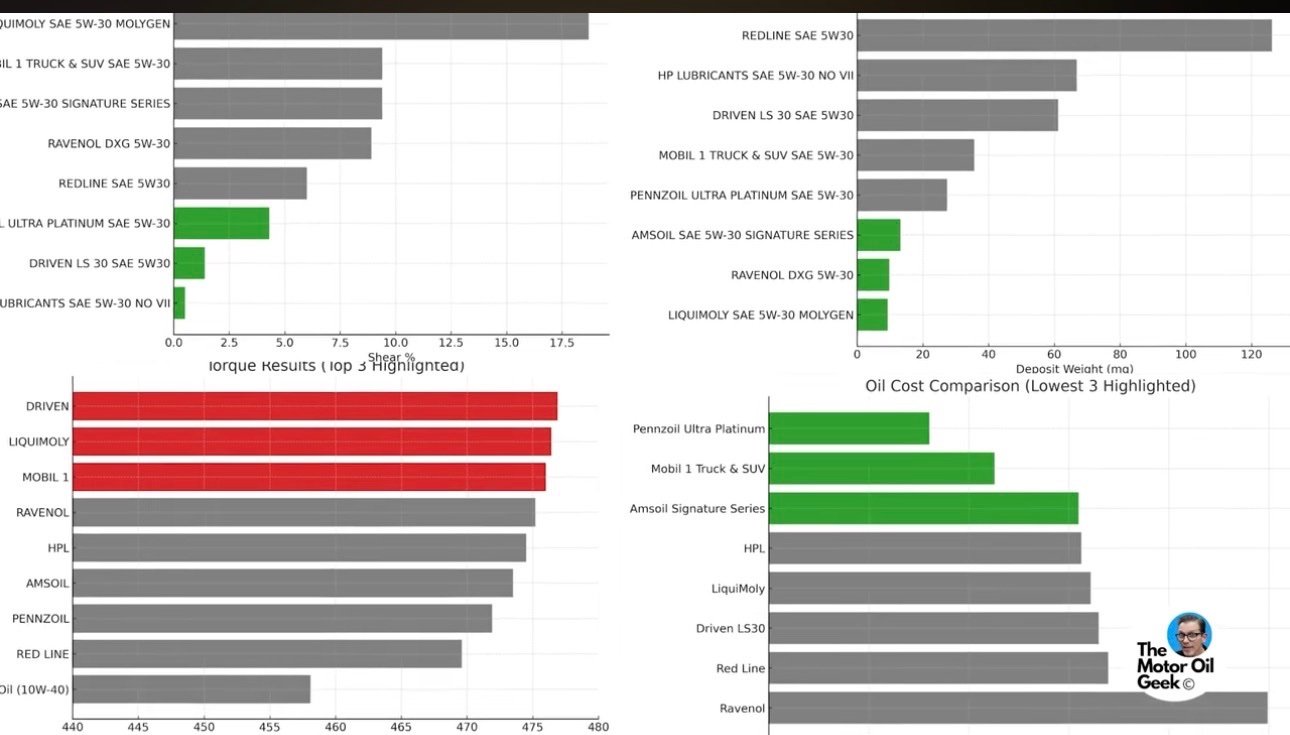

Look to me that Amsoil is best all around for longer drains and low deposits.
Redline shocked me allowing TEOST deposits for turbo. I think they put too much additives in the chemistry. Also it’s very resistant to beneficial shear. Why it held too much heat.
If you change oil more often the silicate additives that ONLY Shell Pennzoil has make the difference. So it’s a good value.
I would just look at iron wear for deciding lowest wear chemistry.

The oils highest in moly did the worst in TEOST. The mid-SAPS Euro blend of RL would have done better for sure.
Iron wear is a 3 PPM spread from best to worst. In the order tested, the first two were highest, (RL, Pennzoil) and then everything else within 1 PPM. Which is curious in its own right. Nevertheless this is all within the margin of error for RDE.

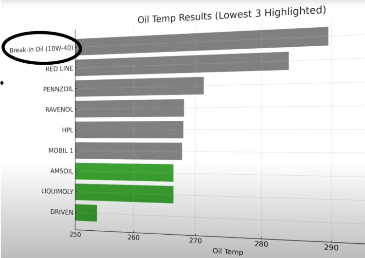

Red Line temperature is a weird one. Viscosity and HTHS is highest but Driven is very close in both specs and did best. COF difference?
I’ve tested Redline TEOST in days past and it did well.
So MOLY is not a factor from a chemistry point of view. Why I mentioned it.
Over-treated additives however ARE a factor because they form deposits.
GOOD observation : Driven is not as overtreated as Redline. It’s also mostly PAO and AN. My take  is the additives are holding heat in the thick base oil of Redline.
VISCOSITY at too high a level or HTHS too high for an engine that just needs 5w-30 is overkill and holds heat.
Note too that this SBC test engine running a “soft cam” was protected perfectly by all the SP rated oils so ZDTP is not necessary outside of API ratings. Even for flat tappet engines.
PS tin napthenate is used with MOS2 formulations thus we see Sn on various formulations. It doesn’t have to be there.

Not selling my stock in Red Line HP but would concede in a turbocharged engine, it’s not going to be my first choice even before the test. Like I said, I have strong reason to believe the Euro spec would be much better.
Maybe I missed it but if this “soft” cam was installed new for this test, some of the increased temperatures and elevated iron could be due to residual break in.
Hear me out. RL was tested first, and Pennzoil second. RL had highest iron, Pennzoil had second highest. RL had highest temperature, Pennzoil second highest. Torque rank…RL worst, Pennzoil second worst. These two oils are complete opposites as far as chemistry, viscosity and HTHS are very far apart. So you have to wonder about flawed methodology…

I hear you and Chuck FB. I’m critical of Lake Speed Jr many times but I’ve been dogging him to tighten up his tribology. This test by Shaver Engines was done very well. The critical flushing between tests and standardized SBC engine was done well. Reminded me of testing I did back in NASCAR qualifying engine work on dyno correlated to teardown and continual hear time oil analysis.
Think of it this way. Drop the brand names and listen closely to the chemistry descriptions. I don’t care about brand I care about value for your application.
I hear you but the engine was fully broken in before first test. Why they use these rings and cam.

Thanks for great input. Any of these oils work well but are you getting value?

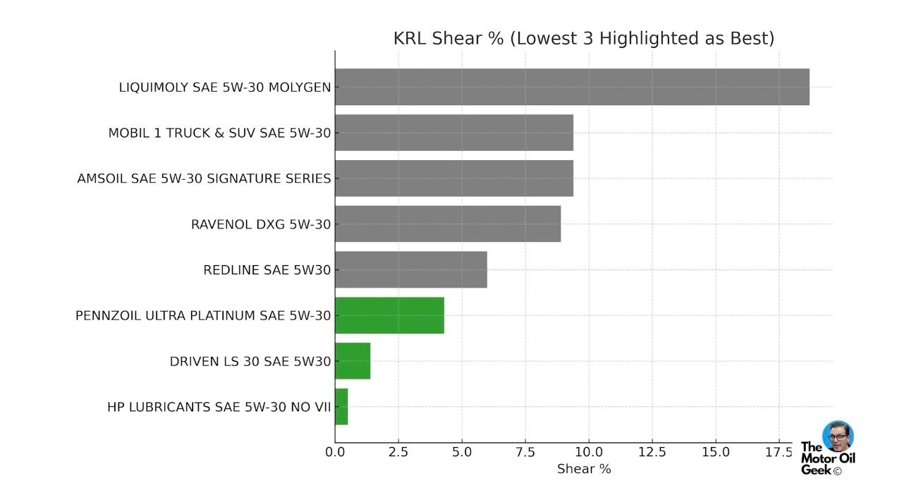

This video is a controlled comparison of eight high-end 5W‑30 synthetics on a flat-tappet small-block Chevy, using both engine-dyno data and standardized lab tests.[youtube]
Oils and test setup
The test compares Red Line, Pennzoil Ultra Platinum, Ravenol DXG USVO, Liqui Moly (Group III formula), High Performance Lubricants “no VI improver” oil, Mobil 1 Truck & SUV, Driven LS30 (older SN formula), and Amsoil Signature Series.  All are run for 2 hours at about 280 °F oil temp, with repeated 3,000–6,000 rpm pulls, and used-oil analysis on a specially designed “fast-wear” flat-tappet cam and coated rings to quantify wear metals.[youtube]
Wear and dyno results
Wear metals (after correcting for tin from moly additives) range from about 8 to 16 ppm over the 2‑hour run, with Driven LS30 and Liqui Moly giving the lowest wear readings and Red Line the highest in this specific test.  On the dyno, Liqui Moly and Driven LS30 show the strongest torque “area under the curve,” while Red Line’s higher base-oil viscosity costs some power and raises oil temperature relative to water by roughly 10 °F more than the thinner Pennzoil Ultra Platinum.[youtube]
Oxidation, shear, and deposits
In oxidation (PDSC), High Performance Lubricants is the standout at about 117 minutes, followed by Amsoil Signature Series in the high‑80‑minute range, with Pennzoil Ultra Platinum and Mobil 1 Truck & SUV clustered around the high‑60‑minute mark; Driven LS30 is weakest here, consistent with being aimed at short-interval performance use.  In KRL shear stability, HPL’s no‑VI oil and Driven LS30 show the least viscosity loss, with Pennzoil Ultra Platinum also performing better than expected and beating Ravenol’s low‑VI USVO in this particular measure.  In the turbo deposit (TOST/TEOST‑type) test, Liqui Moly and Ravenol are essentially tied for best, Amsoil Signature Series is next, and Pennzoil Ultra Platinum is an honorable mention just behind them.[youtube]
“Is Amsoil the best?” — key takeaway
Amsoil Signature Series never really “wins everything,” but it consistently places near the top in wear, oxidation stability, and turbo deposit resistance, making it a strong all‑rounder rather than a single-metric champion.  The presenter’s explicit conclusion is that there is no one universally best oil; each formulation is optimized for a different balance of wear protection, temperature, drain interval, shear stability, and deposit control, so the “best” choice depends on the specific engine and use case.[youtube]

Oil Wear metals (2 hr test) Dyno performance (torque/power) Oxidation stability (PDSC) Shear stability (KRL) Turbo deposit test (TOST/TEOST)
Red Line 5W‑30 Highest in this group  Weakest; least area under curve  Mid-pack  Good, but not top  Mid-pack
Pennzoil Ultra Platinum 5W‑30 Low–mid wear (≈13 ppm)  Good; near top group  Upper‑mid (≈68–69 min)  Very good; better than expected  Upper‑mid; just off podium
Ravenol DXG USVO 5W‑30 Low wear (≈11 ppm)  Good  Mid–upper  Good, slightly behind PUP  Among best (tie for 1st)
Liqui Moly (Group III) 5W‑30 Very low wear (≈8 ppm)  Among best area under curve  Mid  Weakest shear stability  Among best (tie for 1st)
High Performance Lubricants no‑VI Low wear (≈13 ppm)  Good  Clear best (≈117 min)  Best (almost zero shear)  Mid
Mobil 1 Truck & SUV 5W‑30 Low wear (≈11 ppm)  Good  Upper‑mid (≈68–69 min)  Mid–good  Mid
Driven LS30 (old SN) 5W‑30 Very low wear (≈8 ppm)  Among best area under curve  Weakest oxidation life  Excellent; near top  Weak on deposits
Amsoil Signature Series 5W‑30 Low wear (≈11 ppm)  Good; not top of pack  2nd best (high‑80s min)  Good; not class‑leading  Very strong; 3rd, close to top

Depends how they actually perform in your own vehicle and whether or not that even matters to someone. I’d like wear as close to zero so I don’t mind splitting hairs. And my lead foot can expose weaknesses of certain oils very easily.
These bench tests are fun and can be informative. But most people are lazy and just blanket apply their results to every vehicle and every operator. Even something like oil temp is highly variable. I’m on 5w50 RL (5.0 HTHS), I log everything, and I haven’t seen any increase in temp vs any of the other oils I’ve tried in lighter grades. None.
The difference he measured between RL and Driven is astounding in comparison. I really don’t see RL 5w30 being too thick for any SBC. But would have been interesting to see him run 5w20 RL instead. Many people actually drop a grade when switching to Red Line so it would be logical.
