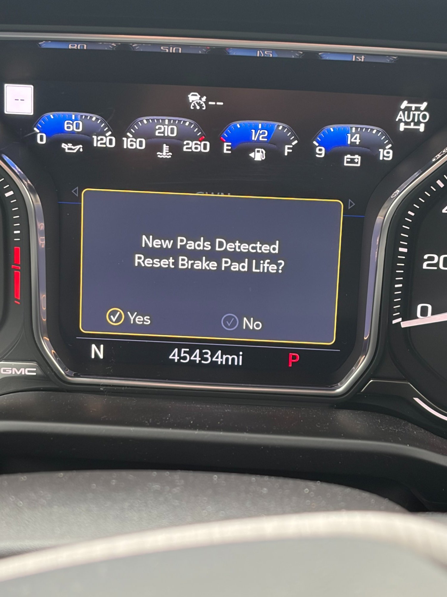

Yes, that works.  The concern I have is whether or not I really want to do that every time I use remote start throughout the winter.  Additionally, I've started getting an unusual message when I start my truck (with the module in).  It says it noticed the brake sensor was engaged and asks if I want to reset the brake pad monitor.  I'm pretty cost to returning this.

I started the process to return my disabler today.  On top of the remote start issue, I started getting an errant message about my breaks that does not happen when the module isn't plugged in.  I've not had anyone touching my brakes and they are still the original brakes.  I don't want to deal with this from a $200+ product especially attached to a $30K vehicle.  I'm going to look into other options, probably a tuner.  Or, I may just wait and if I get any lifter issues, do a hard delete of the afm/dfm system.
