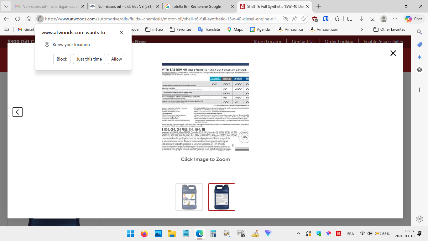

One thing missing from the oil geek’s video is an explanation of how the Rotella T6 can also be classified as SN—how can it be both? Screenshot(5).thumb.png.1624d71fb47b9050f312fd2b2437567d.png
Because it will met the requirements of either; along with a few manufactures requirements. This might sound silly but it works a bit like; "Not all eggs are chicken eggs but all chicken eggs are eggs". In the oil universe this formulation is both chicken egg and egg in a universe where all eggs are chicken.
Many SAE and API requirements are 'one directional'. That is they may have a minimum but no maximum or visa-versa allowing a single formulation to meet the requirements of many standards.
