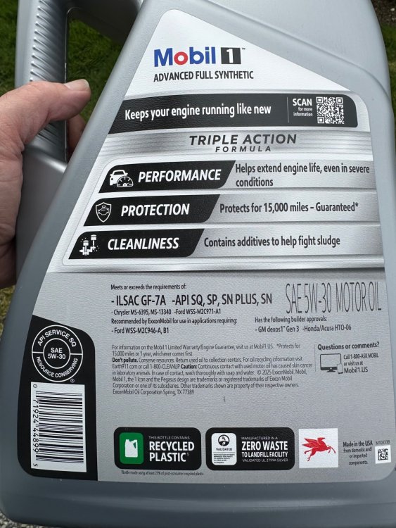

Some (or maybe just one) of the Mobil 1 5w-30 variants have a large Dexos flag on the front label of the bottle. However, it seems like all of the ones that don’t have that flag still have a fine print statement on the back label that they meet the Dexos spec. Do you know if the two types of labeling mean the same thing, or is one type licensed and the other aren’t (but they still claim to meet the spec?  Thanks

Not exactly. Remember in grade school hearing that math axiom, "All squares are rectangles but not all rectangles are squares"?
When an oil flies the DEXOS flag it means it is, 1.) Chemically compliant 2.) Performance tested and passed 3.) Paid my dues to fly the flag. 4.) GM knows exactly what's in the bottle and we have an NDA.
When an oil only says on the back label, "Meets the DEXOS spec" it could mean a few things. 1.) It is chemically compliant and it does meet the test standards but I'm not paying you nor am I giving you my recipe. (Valvoline R&P) 2.) Is not chemically compliant yet meets performance testing. (Mobil 1 ESP) 3.) Is not chemically compliant and far exceeds performance standards. AMSOILSS/Red Line HP/TORCO SR-5.
Oils like AMSOIL, Red Line, TORCO, and even Mobil 1 ESP far exceed the performance standards, do not comply with the favored chemistries and couldn't be licensed even if they wished to be.
GM would like people to believe that any oil not DEXOS licensed is sub par. Simply not true. Most of the boutiques and a handful of Big Box oils out perform in spades. Give you just one spec to chew on. DEXOS1Gen2 NOACK standard is 13% and that was improved by DEXOS1Gen3 to 12.5%. (Lower is better) AMSOIL SS 0W20 has a NOACH of 8.5 and the 5W30 is 6.7%. Red Line HP 0W20 is 5% while the 5W30 is 6%. Both of these oil exceed standards by half or nearly so.
Cleanliness or deposits. AMSOIL is 40% cleaner than Gen2 oils. Fact, cleanliness, deposit and sludge control of Gen2 licensed oils is the same as API SN+/SP. Neither were clean enough to keeps rings free thus the Gen3 oils, which still aren't as good.
