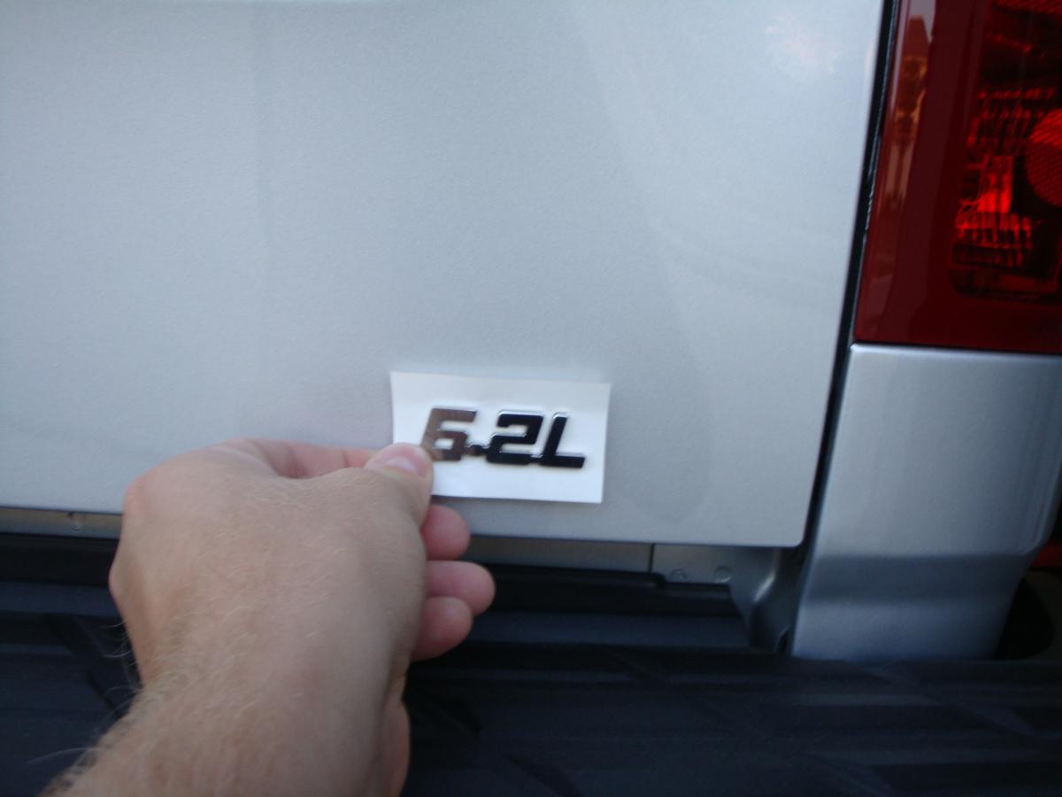

Do you just have the one on your tailgate? Pictures please Thanks

I was the first to have those top flight badges and dont forget that :)
Search over in the appearance section for a thread I created to vote on where I should have put them. There are pics with me holding it up in various locations on the truck.
Edited by RyanbabZ71
Thanks for the pictures. @ $30.00 each I am just gonna put one on the tailgate for now. :thumbs:
Wasn't trying to steal your thunder :cheers: . Didn't know you had those badges on your truck also.
I do remember getting the link from here though.
Here is one on the tailgate for reference
Gotta love that 6.2L! :thumbs:
