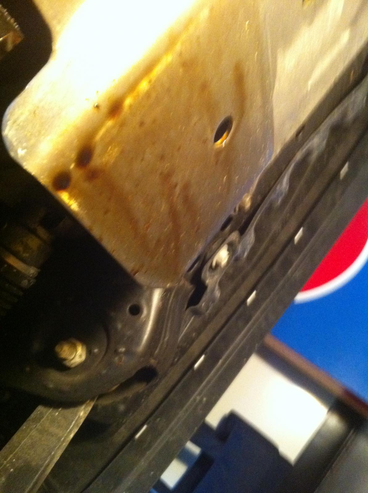

Seems to have gotten worse now that it has been consistantly colder out. Looks like it will be going in next week :(

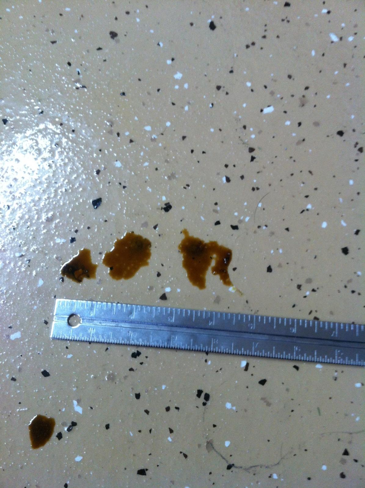

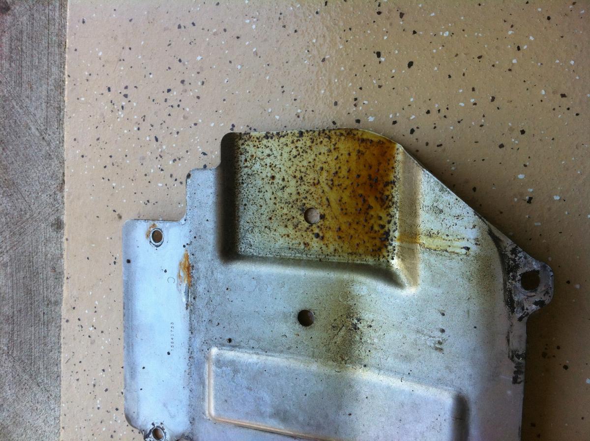

Dont know havent been able to track it down previously. It was dripping on the floor and I would only see a drop like the middle pic once every few wks. The is only the second time I have seen any spots on the ground in the garage. Now that it has gotten cold it is leaking more. Oil level is still good . Tomorrow I plan on pulling the skid plate and taking a look.

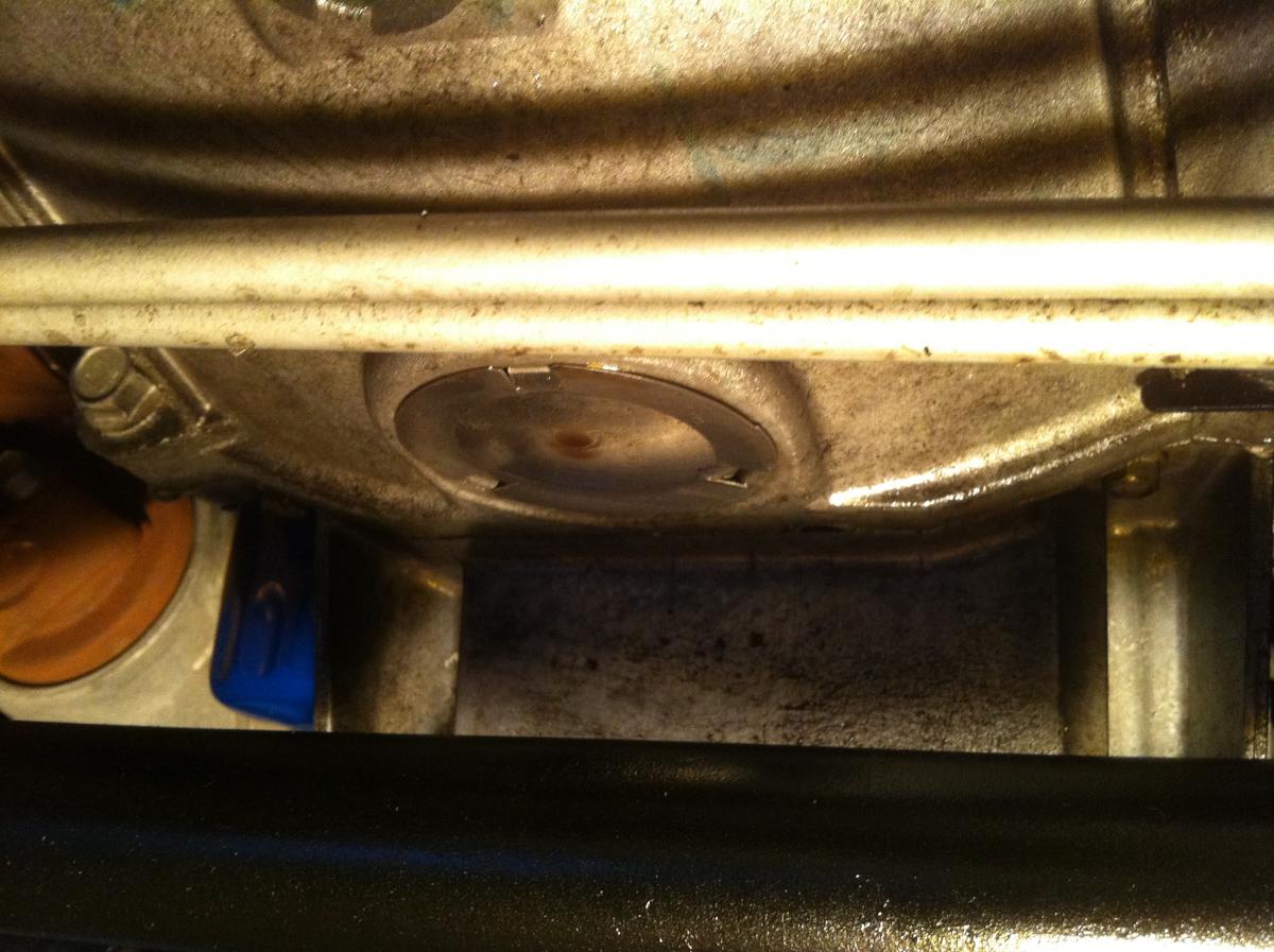

Mine had a *very* slow seep at the oil pan gasket, and would eventually wet the bottom of the motor. That's a lot more oil than I had, but it could still be the pan gasket. Mine had sit for a while before I bought it, so I expected something like that could happen. I recall that you ordered yours?

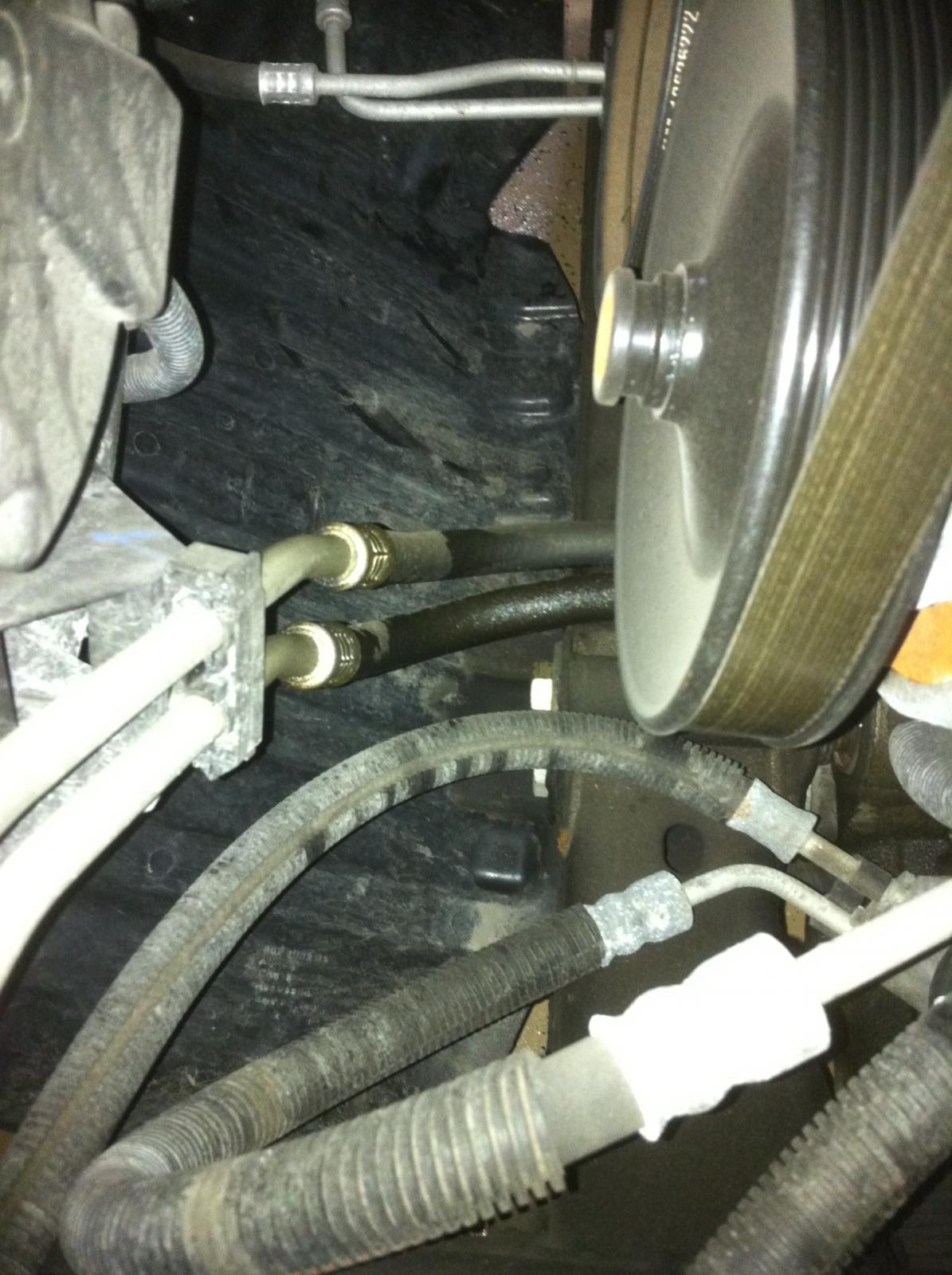

Not 100% sure but I think it may be from the oil cooler lines? Also there wasnt all that much oil on the inside of the skid plate.
The lines sure do look wet; maybe that's all it is. I had a leak early on with my truck (around 5000 miles). It turned out that mine was a power steering hose that was leaking. Sure made a mess, but I was mighty glad that was all it was. A new hose, a little simple green & the garden hose after the repair and all was good. Hope you get as lucky.

Well after cleaning it on Saturday and taking a short trip Sunday morning, there were no leaks Sunday evening or this morning. After driving back and forth to work it had started to get on the skid plate again. I did some digging and found one of the lines under the hood wet (see photo). Have an appointment for Friday morning. We will see :(

Well got the truck back. Issue was a bad oil cooler line. God I missed the 6.2 for a day, I had to drive the darn 5.3 Tahoe
