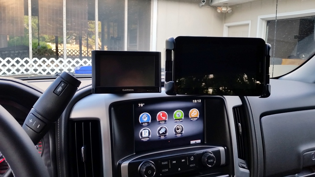

That looks slick, well done! I'm a big fan of PanaVise for my Garmin and Tablet I have mounted on the dash though I really like RAM and their adjustable mounts.

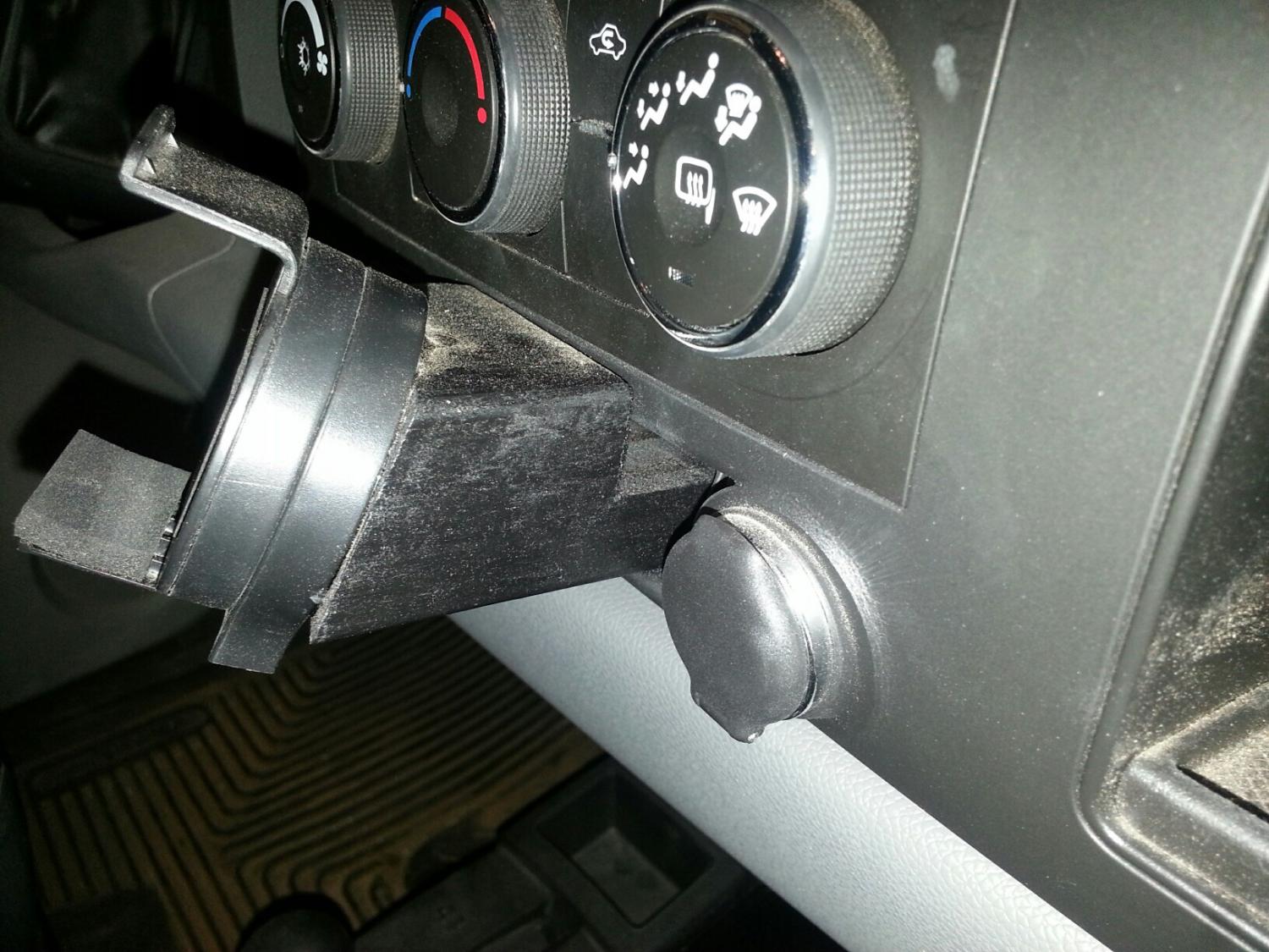

Mine is a bit more primitive. I used the clamping portion of a mount that I broke. Add a piece of 2x4, some epoxy, some black paint and a little Velcro. The mount rotates 360 and my hillbilly engineered bracket is held on with Velcro.
