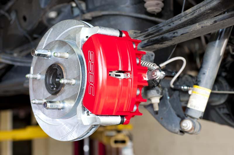

I went through two sets of OE front rotors that warped before changing over to SSBC rotors/calipers front and converted drums to SSBC discs in rear on my 2011 Sierra 1500. No more brake problems. Expensive upgrade--but one that eliminates brake problems when towing boats and trailers where heat build up is a real issue at times.
