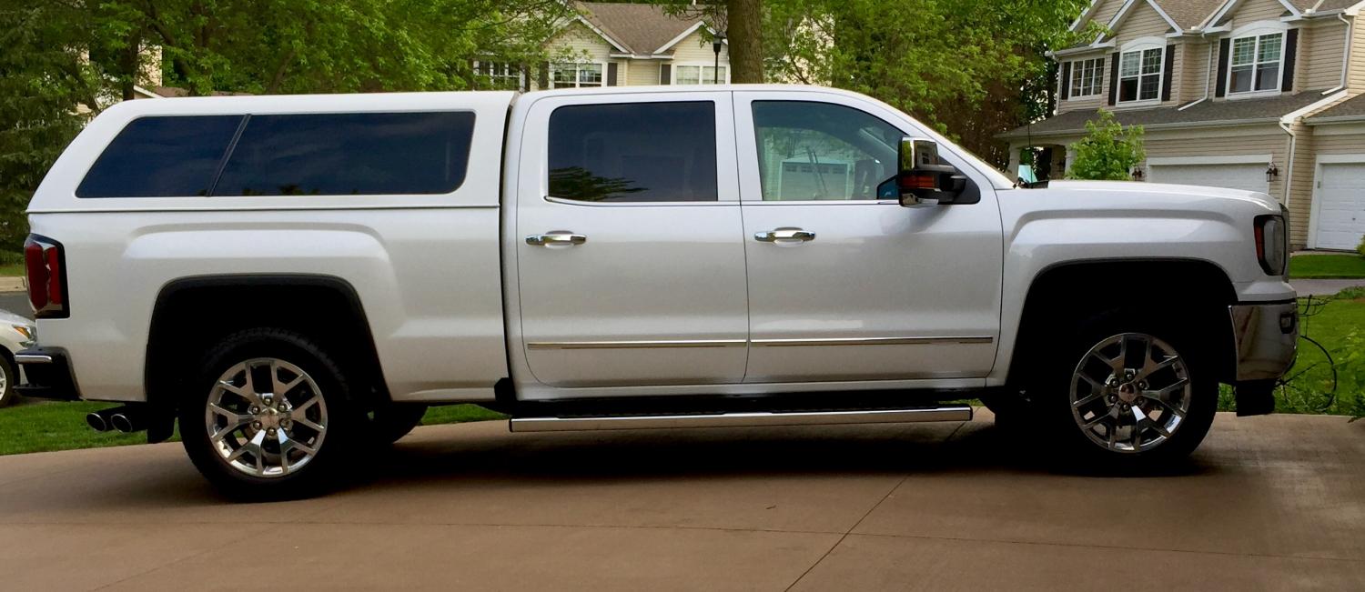

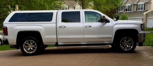

Well I went and met the guy this morning and it fit well enough for my occasional use. Fits great front to back but the rear of the bed is narrower by an inch or two than the front so it's not perfectly flush side to side. I also have to trim the back door to clear the trucks tailgate and reinstall the weather strip. If you are planning on permanently mounting it I would buy a new correct one hands down. For weekend occasional use it will get the job done.
Well I got here too late but was going to tell you that. The caps for the 2014+ trucks are designed differently (not just the dimensions but they have a lip all the way around that wraps down over the sides and covers the black bed rail caps). If you are leaving it on permanently or removing it very often go with the new ones designed to fit. Also the bed rails have a little more "arch" from front to back on the new trucks so if you pull your cap down tight keep an eye on the fiberglass since it will eventually start to splinter (the bottom rail of the older caps is flatter than the newer ones).
Hope this all makes sense ...
It all makes sense and thanks for the information. I used thick foam along the perimeter of the bed rails that when tightening down the clamps basically leveled out the cap. I trimmed the back door yesterday and now it shuts tight. I may trim a bit more and add a piece of rubber as added piece of mind for keeping water out.
I'll only use the cap 3 times a year so it'll get the job done for now. Worse case is the fiberglass cracks and I cut it up with a sawzall and order a new one next year. Just wasn't looking to spend 2500 right now.
