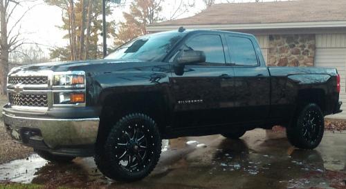

Finally finished all the mods, here is some info for those looking for it.
- 2inch rough country leveling kit
- 305/55/20 Nitto Terra Grappler G2
- 20 inch Fuel Maverick Wheels with a 20mm Offset
And before any one asks, No rubbing on the fender lining and suspension at full lock. I also didn't trim a thing.
