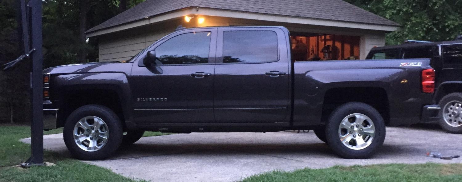

Ok just got all done with the leveling kit. First picture is of the day I picked it up.
Second and third picture is of it with just the front RC spacers installed.
Next to my dads 2015 high country
Measurements were:
39 front wheel well
38 rear wheel well
18 front of cab
17.25 back of cab
Here it is with the 2 in blocks in the back
39 front wheel well
38.75 rear wheel well
18 front cab
18 rear cab

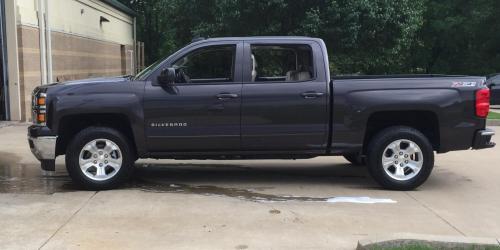

I'm finally home with the new ride and I love it. Put some miles on it today, got it with 16, got home with 150ish. but I can't be watching the odometer like that or I'll never wanna drive it lol
Leaving this
Now driving this
