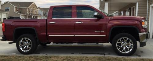

Just finished a TGC 2.5" leveling kit and definitely loving the new look. Quality of the kit is top notch. Starting with just the lower spacer and it wasn't high enough. My truck's rake was right at about 3" from the factory.
Before
After

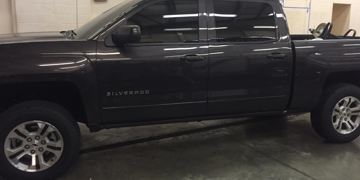

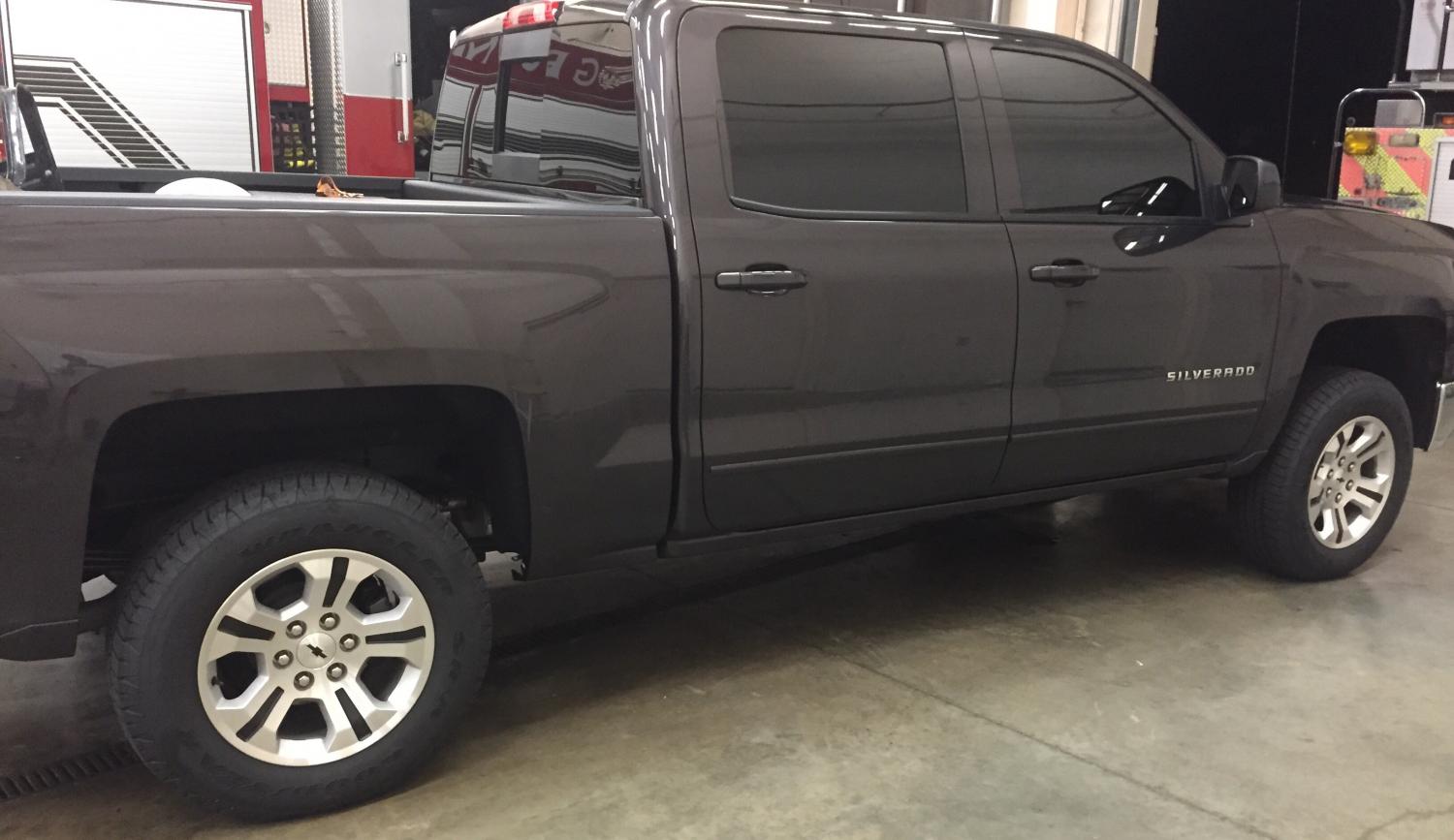

Ok just got all done with the leveling kit. First picture is of the day I picked it up.
Second and third picture is of it with just the front RC spacers installed.
Next to my dads 2015 high country
Measurements were:
39 front wheel well
38 rear wheel well
18 front of cab
17.25 back of cab
Here it is with the 2 in blocks in the back
39 front wheel well
38.75 rear wheel well
18 front cab
18 rear cab
