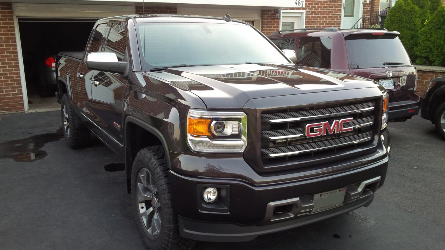

That is quite a difference!! Didn't look bad before but surely a change for the better.
2.5 rc inch level kit 33 12.50 toyo at2 extremes no rubbing at all. First pic is obviously before much of anything was done to it.
I'm trying to figure out what size tore I should get next. I currently have 35's with a 4" suspension lift and 1.5" body lift. When I need new tires. I am going to replace the lift with the 2.5" leveling kit from RC. My rims are 0 offset but I have 1" spacers that I will take off and put on 1/4 spacers at the same time as the suspension swap.
After this happens. I will have 1" wheel spacers and the 4" lift for sale hopefully. If I get any interest. I might even consider selling my Bushwacker summit white fender flares too.

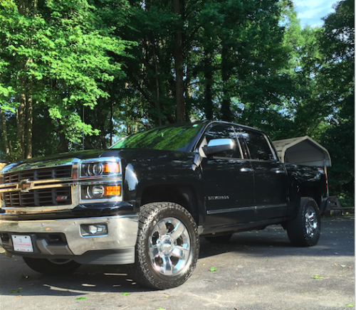

Here's mine. 2.5 kit with 275/70/18s
awesome truck. any more pics of this setup? what leveling kit is this?

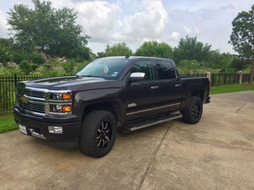

Readylift 2.25" level kit. 305/55r20 Nitto Terra Grappler G2. Moto Metal MO970 +18. No trimming needed, only zip tie the wheel well lining.
