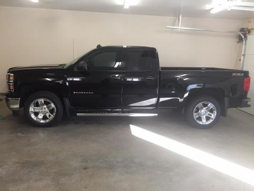

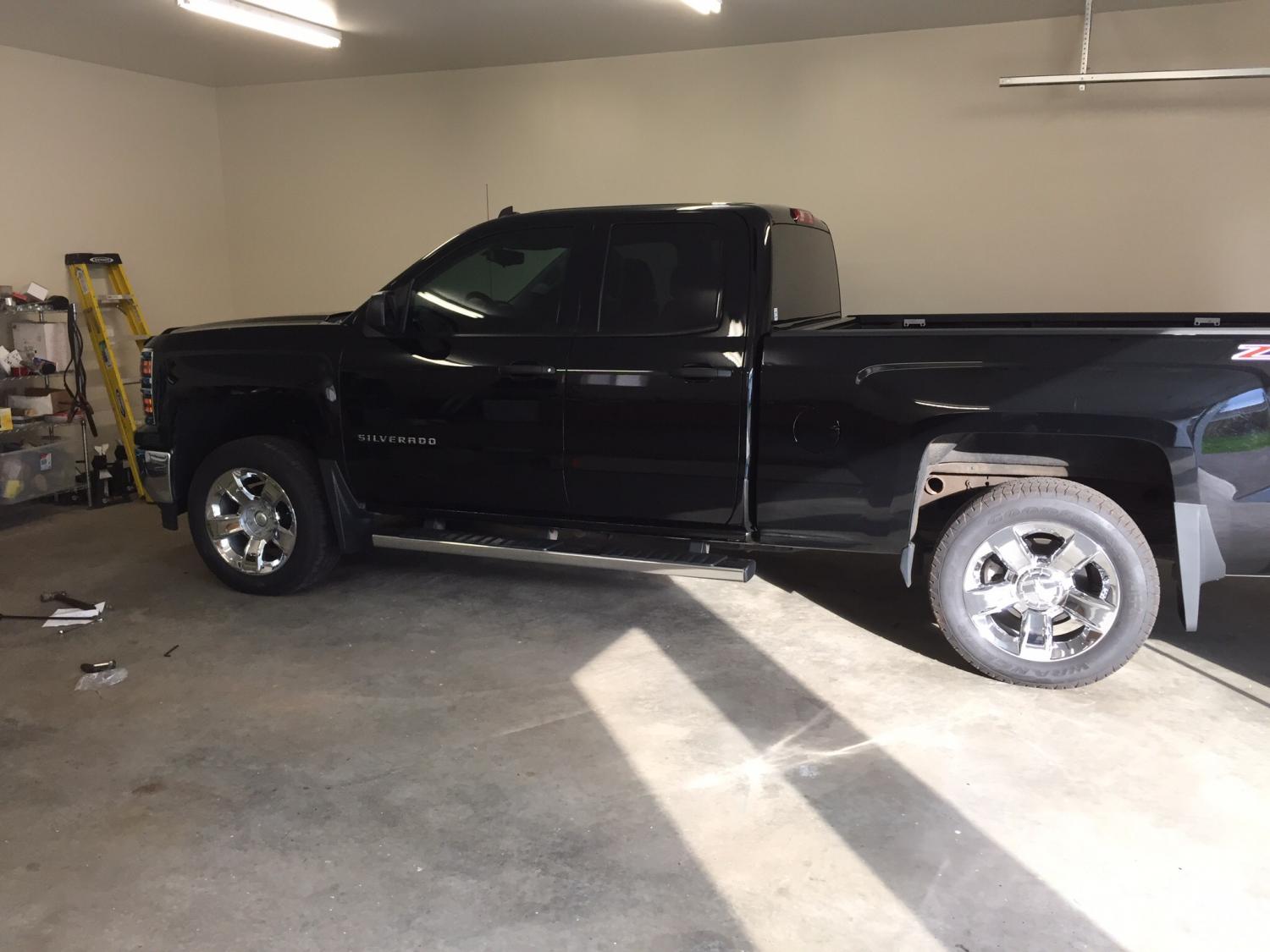

Got the pro comp level today and Zone 1.5 body lift. I have a few questions? The upper spacer on the strut can you see it by looking ? Or is it under the metal cap ? Second there is a gap between the the rear bumper and bed. I don't think he installed the rear bracket to raise it ? Thanks for the help.
How big of a gap on the rear bumper mine looks stock with a bigger gap to the hitch with the zone 1.5
That's what I thought. He didn't finish the job thanks. He never raised the rear bumper.
Yea sounds like it not sure on the pro comp level but the rc2.5 level you can't see the upper spacer
