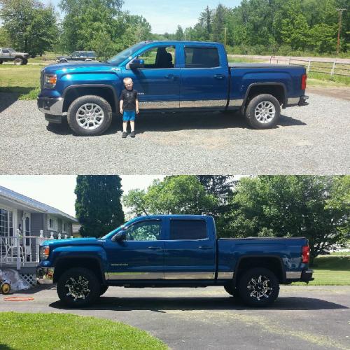

Finally decided to get a leveling kit.. Went with the 2.5" Rough Country Leveling Kit.. Also got it installed today!! So far I really like it, ride is pretty good.. Didn't put the rear block on that came with the kit yet.. Want to see if it will settle a little after I drive it and get an alinement done...
I bought the RC 2.5 kit with the rear blocks online and had my local shop install for $120 that included the alignment. I had new Toyos put on at the same time. It was well worth it to have them do it IMO.
Before
27160BD5-655E-47B7-9F5C-BE5F1B7DF708_zps
After
1FABA1A3-E2FE-437C-BD4D-D5FF0366B69B_zps
Before
After

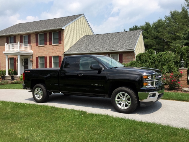

Picture of my '15 DC with a 1" front end lift. Still has some rake, but surprisingly, 1" front end height adjustment makes a big difference. Stock 265/65-18 tires/wheels.
Summit Performance. Really simple, just a 1/2" thick billet alum machined spacer and Grade 8 bolts. Bolts that come with it are no longer than the factory bolts. Was able to install without touching the ball joints, all I had to do was put the front end on jackstands, loosen up the sway bar links (do both sides), took a little bit of prying up on the bottom of the shock. I put the bolts in from the bottom (just like the factory bolts) and reassembled with red Loctite on the threads as a safety measure. Have put a thousand miles on the truck since installed, still tight, no signs of movement. From what I could tell, every other level kit that uses a bottom spacer, with the exception of the Rough Country 2" kit, all are made of machined aluminum. 1" level kit only spaces the shock up 1/2", personally, this is limit of how far I'd want to shim up shock above the control arm. I think a 2" lift via a spacer will increase the sheer load on the bolts to a much higher level.
