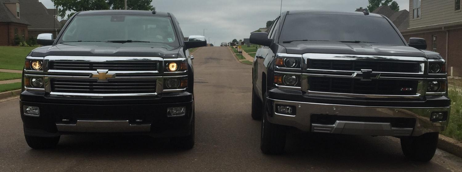

Yeah my truck now sits 39 inches high in front, 38 in rear. So I guess I'll be putting the RC blocks on the back. Here a picture I took of the it sitting next to my dads 2015 high country today
