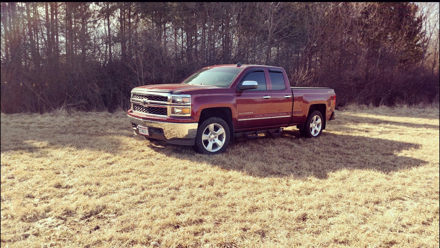

Here's another picture. As to why well I'm from California and here it's a style. What works for us might not work for others and what works for others might now work for us.
I too am from California and am partial to the lean. I leveled mine front only and was thinking about removing the rear blocks. Its crazy how different the angle is on those two pics. Makes me think removing the block wont even make a difference lol

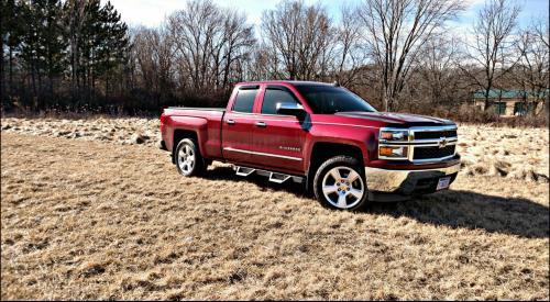

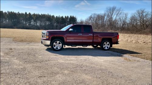

Installed mine today, looks way better! IMG_20160227_224434.jpg IMG_20160227_224604.jpg
Looks great but installed what?
Guessing a levelinf kit? Stock tires?
Sorry, yes a 1.5" motofab leveling kit. I'm running stock tire size right now, but have Hankook Dynapro ATMs. I'll probably go a little bigger next time I buy tires. Now I'm looking for some rims to match my new side steps.
