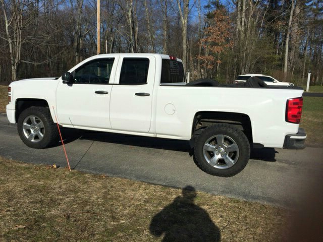

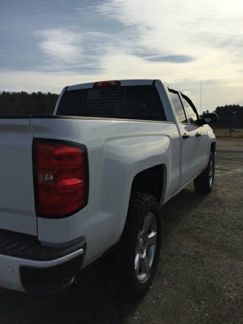

post-129300-0-78412000-1456770917_thumb.jpgpost-129300-0-26755200-1456770937_thumb.jpg
Finally got some tires on. 285\60r20 duratracs. I didn't think they would rub but they do on the sway bar at full lock. Going to put on .25 spacers to see if it helps.
Lift is 2.5 rc in front and 1.75 block in back. I'm thinking about going back to the stock block and putting on a 1.5 body lift but I can't decide
