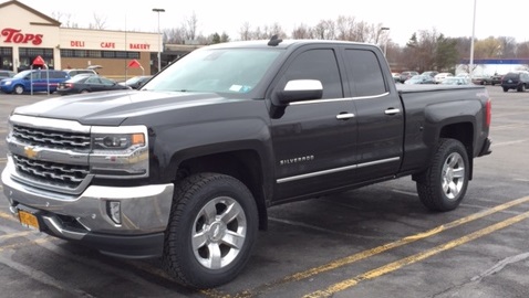

If anyones curious and likes a little bit of rake (im a muscle car guy so to me it looks aggressive). I used the 2.5 RC kit and left the top .5in spacer off the front. So 2in front. 1in rear(2in rear block). Im happy. Truck looks stock, just higher. Went with 275/65/20 bfg k02s... dont rub at all. Wish i went bigger but still averaging 18.5mpg overall. If i went with a wider tire i feel this would be worse. Ps. BFGs run NARROW!! IMG_20160306_180540_zps6wyxbxwc.jpg
This is the stance I've been looking for. Perfect in my opinion love the look. Question is if you were to do it over would you go with the 275/65/20s or 275/60/20s? Again great stance

Thanks. I'd go 275/65 at least. Maybe bigger. The 65s don't rub at all and don't even look particularly big to me. They are kind of narrow too at least in bfg flavor. Long story short: I had more room underthere than I anticipated based on how everyone talks on this forum.

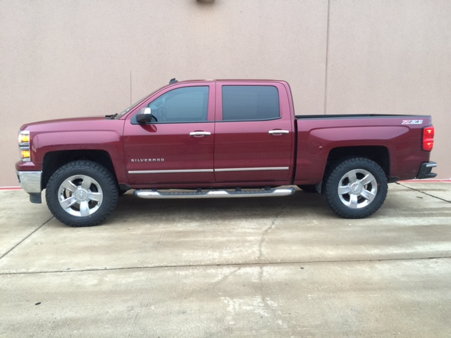

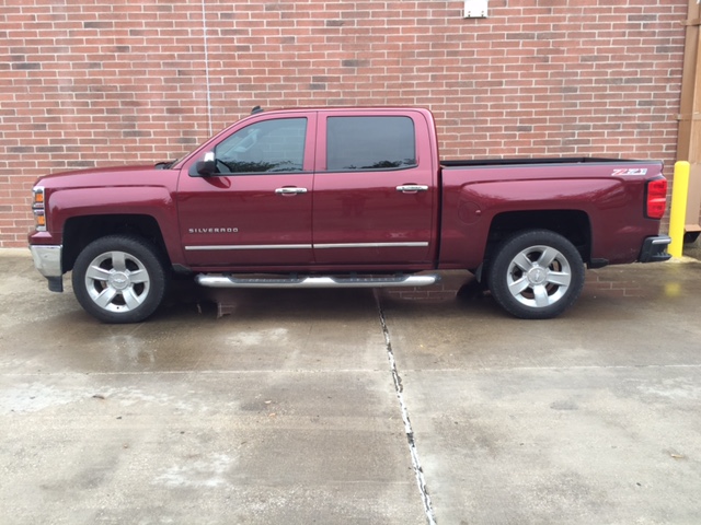

2014 LTZ Z71 Silverado
Rough Country 2.5" leveling kit (front only)
Stock 20X9 +27 wheels
BFG A/T KO2 285/65/20
Before leveling kit:
Front - 36 1/4"
Rear - 39 3/8"
After leveling kit:
Front - 38 1/2"
Rear - 39 1/4"
After tires:
Front - 40"
Rear - 40 1/8"
I did both the leveling kit and the tires today, so I wouldn't regret my decision when I saw the MPG drop :)
I've driven about 40 miles and have not rubbed yet, going through tight parking lots and pulling in the driveway. I don't think I've been at full lock yet, because while not rolling, it is on the liner. Plan to use zip ties rather than cutting. Going to see what happens over the next few days.
1st Stock
2nd Leveling
3rd Tires

This post and the post by patrick983 couldn't have came at a better time for me. I'm torn between these two sizes of this same tire with this same level kit. 275/65-20 or 285/65-20?!?!?
Aggieguy, could you possibly take an front angled pic and a straight on front pic and post?
Much thanks if you could!!

You wanted to make sure we saw this truck, so you posted it on three different threads! J/K :)
Get a bungee and turn your wheel all the way in either direction. Use the bungee to hold your steering (lightly) at full lock. Now look at the spacing between the back edge of your tire to the swaybar. Is it hitting? Go to the other side of the truck, and look at the spacing between the upper control arm (UCA) and the edge of your tire. Is it hitting? You can cut and tie-strap liner, but you can't do anything for swaybar or UCA rub except move towards neutral or negative offset. New rims or spacers...and we all know about spacers.
My fear on swaybar/UCA rub is that the tire is not very thick in the sidewall, so I don't want to wear that or heat it up and lead to a blowout. I'm running a 10.83" wide (275) tire, and at full lock with a +24 stock rim, I have 1/4" of UCA clearance at full lock....I have about 1" of swaybar clearance, but the swaybar has a curve to it, so a taller tire actually makes it worse. I was all set to go 295 or 305, but with only 1/4" clearance, it just ain't gonna happen. I'm even starting to have doubts a 285 won't hit. The best way to solve this problem is 0 offset rims on these trucks. Not sure it's worth it to me.....yet.
