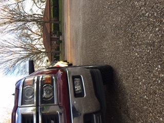

Rintintin can you post up a pictire or 2? Down the side and profile pic.
Please check my page. I posted some pics. I apologize for the delay. if you need pics at other angles please let me know
Like to see the same, checked his gallery but not good angles of stance and wheels/tires.
This post and the post by patrick983 couldn't have came at a better time for me. I'm torn between these two sizes of this same tire with this same level kit. 275/65-20 or 285/65-20?!?!?
Aggieguy, could you possibly take an front angled pic and a straight on front pic and post?
Much thanks if you could!!
Here is a down the side shot, I'll see if I can snap a few more tomorrow.

At full lock, I'm clear of both the sway bar and UCAs on both sides. I have rubbed a few times driving today, and will investigate that in the light tomorrow. It wasn't vibrating the steering wheel at all, so it was not as bad as I thought it would be. I'm hopeful zip ties and done!
I think a 295 would be pushing it and a 305 would definitely rub both sway bar and UCAs on the stock wheels. I really would like to push them out a little, as I wanted to have just a bit outside the fender, but don't feel like making the investment just yet.
I loved the truck already, but now am really digging how good it looks. Especially when parked next to a stock version. I've got another 150 miles on it since the first day and am getting 17.1 on the highway on the DIC, so I'm happy so far.
