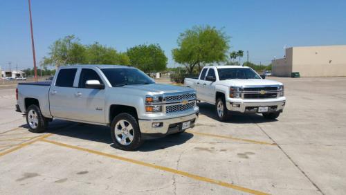

2.5" rough country leveling kit. Didnt use the rear block that came with it. Still has .5" rake but also has a ranch hand on the front.post-155891-0-53237300-1458932867_thumb.jpg
Edited by jsouth
Got some fresh pics of the his and hers haha
