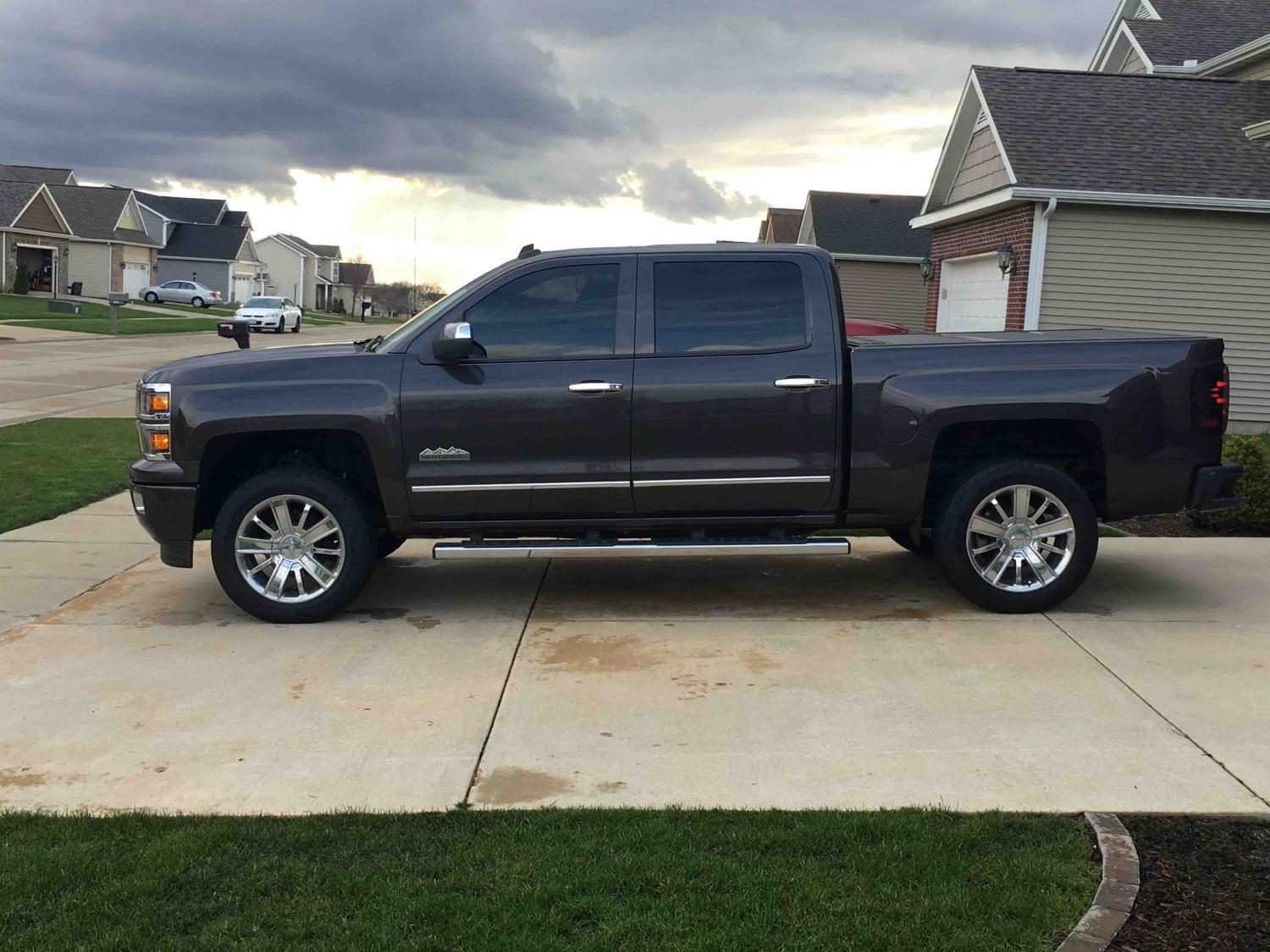

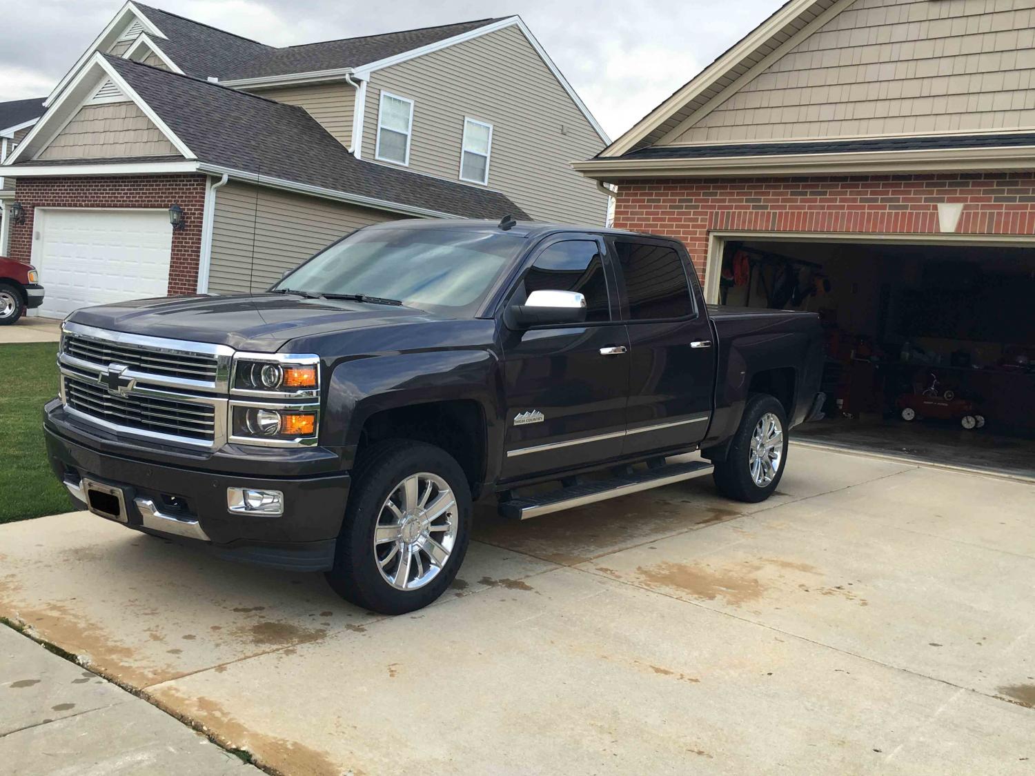

I installed the 2.5" rough country level. I didnt use the rear blocks though because i have a ranch hand on my truck. It still has 1/2" rake. Looks good and havent had any issues in 500 miles. I searched through every leveling kit i could find. I only went this route to be cheap and save for either a set of king shocks or maybe go with a fab tech suspension lift with fox shocks. You might look into bilstiens 5100 height adjustable shocks. They look like a good deal for all 4 corners for just under $400. I think these silverados ride like crap so i dont think you can make it any worse. I havent actually noticed a difference in ride quality.

I had the 2.5" RC kit on my truck for about 15k miles. No issues and the lift was exactly what I wanted. Over time though, the ride got rougher. Pretty damn jarring over a good bump or RR tracks (I'm sure the stock Wrangler SR-As don't help either as they are garbage). Did a little research and thought I'd save a little $$$ by just replacing my rear shocks with the Bilstein 5100s to help. (I have the rear block form the kit installed as well). I couldn't believe the difference in ride just by changing the rears. Drove to work the next day, got online, and immediately ordered the 5100 front adjustables. I just put them on, on the highest setting, last weekend. Basically removed the front lower strut spacer and left the 3/8" upper spacer from the RC kit on top of the Bilsteins. Gave me right at 2.6". The ride is incredible... Feels like a Cadillac. Very responsive and smooth, yet stiff and soaks up the bumps so nicely. If that makes sense. Here's a few pics of how they look. Tires this weekend!

My opinion only.... I have ran both....... The Bilstein's ride way better than the lower spacer kit I had on stock struts. Just depends on what you want really. 2" kits are around $65 from RC, I believe. (Installs in 2 hours for the novice). However, 5100 Bilstein adjustables are anywhere from $105 - $130 ea. + costs to install on stock spring. (Installation we'll say 3-4 hours counting taking the struts to a shop to have them swapped out). Either way you'll also have to pay for an alignment as any level will knock toe out of wack. Bilstein's say 1.88" at top level, but I got over 2" with them. No need for spacer with them if you just want 2".
Others may have a different experience than mine though. I just thought the spacer rode rougher as time went on. Hope that helps.
