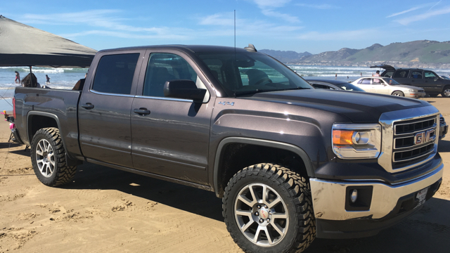

I have the 2 inch RC level on my truck and I sit 3/4 of an inch higher in the back than in the front. Every truck is different but I am happy with the way mine turned out. I didn't want to be super nose high every time I put something in the back or pulled a trailer so it worked out well for me. Best way to get want you want in height is to measure your wheel well height and decide how much you want it to raise the front, then go from there. (1.5, 2, 2.25, 2.5 etc.) You will also have to get a front end alignment after installing any lift to prevent premature tire wear. Here's my build, hope this helps..
http://www.gm-trucks.com/forums/topic/181879-my-new-2016-gmc-sierra-ccsb-z71-slt/?view=findpost&p=1742013
